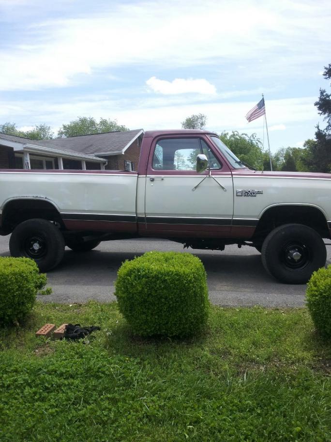

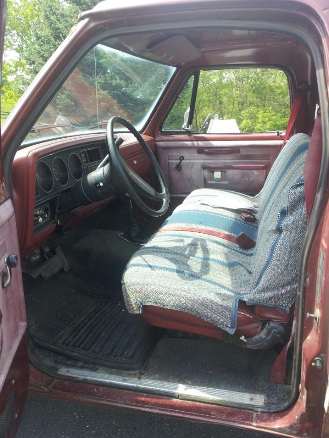

This is my 1985 w150 power ram prospector with the 318 in it. Any suggestions to give it more power? It has the stock intake and carb on it and its kind of turdy. It seems like it should have more power. Also, if I remove the smog pump and charcoal box will it free up the engine a bit more?

Your truck does not have a 302, it has a 318.
Besides that confusion, just start replacing worn out stuff: spark plugs, distributor cap and rotor, wires. Once that is checked out, do a compression test to see if the engine is even worth messing with.
