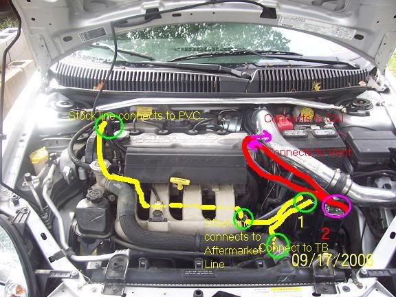

routing it: (the yellow is the one to be more concerned with). and it really attaches to the intake mainfold, not the throttle body. although they are side by side

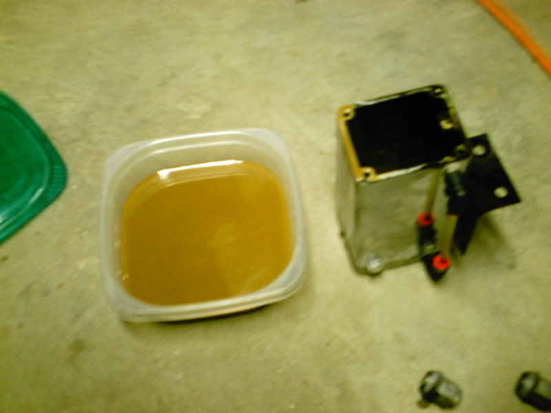

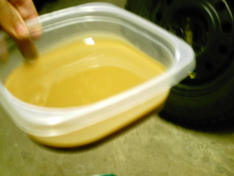

here is what it 'catches'

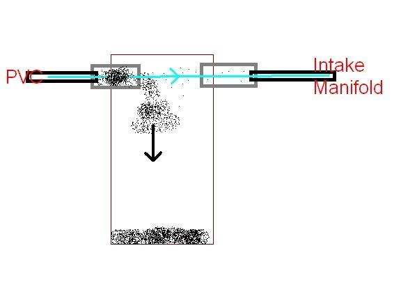

and a little bit better of a design, since gravity makes the liquid fall, why not try to prevent it from 'blowing through' the catch can as well by putting the inlet below the outlet? only down side is emptying more often.
