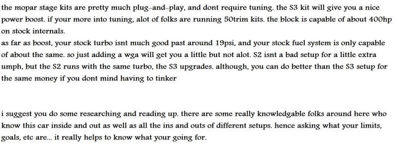

Old Jul 29, 2008 | 07:56 AM
flamingpinhead's Avatar
flamingpinhead
Section Moderator
Joined: Apr 2006
Posts: 4,505
From: Pennsylvania
Default RE: i wanna upgrade my turbo?
