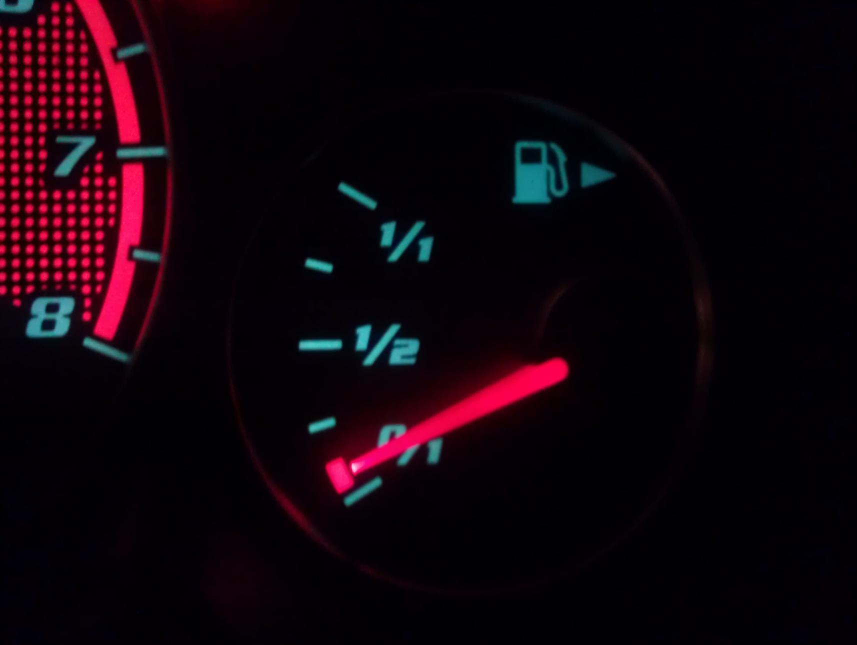

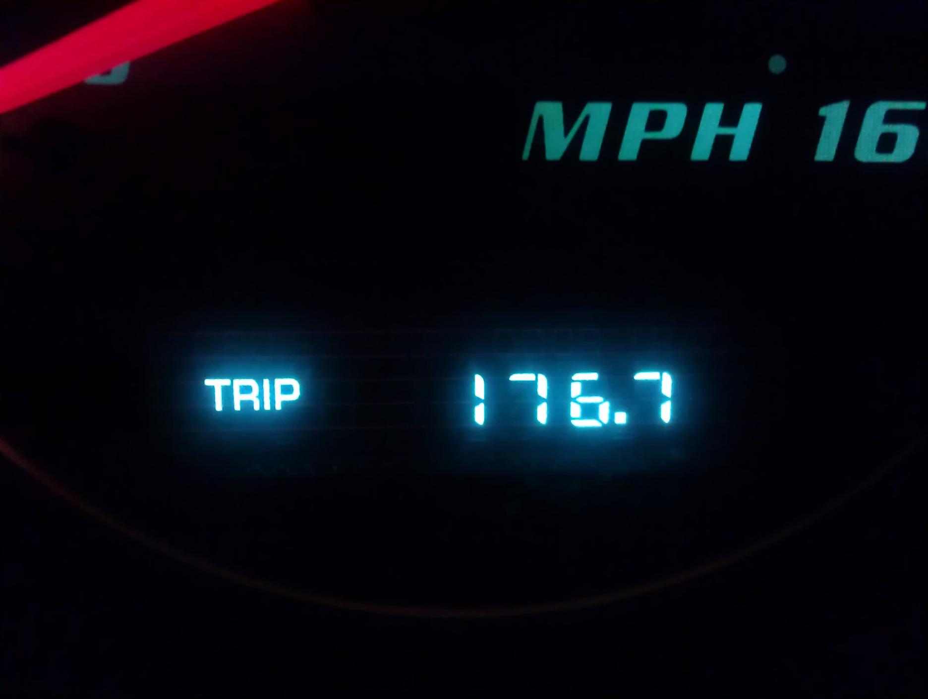

After flooring(wot) my car for the 1st time at 10,000 miles, breaking it in perfectly with patience. Always changed the oil after 3,000 miles using Mobile 1 5-30. Changed spark plugs every 10,000 miles along with cleaning filter. Always checked my tires and alignments. The car is a beast runs great like no other banged up srt4 on the streets. Full gas tank always ran about 240-260 miles. After 50,000 miles this year ive been getting horrible mpg. 170-200 miles per tank!!!Yes and this is babying it without hitting 1 psi of boost, and shifting around 2000-2300 rpm till 5th gear.
Im throwing no codes. I changed both O2 sensors. Ive changed my whole brake system thinking i had a brake issue. YES I only use 93 octane gasoline.

Attached Thumbnails Horrible mpg Srt-4!!-imag0174.jpg   Horrible mpg Srt-4!!-imag0175.jpg

have you always just driven in the city? because it only takes about 10 gal to fill my srt up so if you get 170 per tank and it only takes say 10 gal thats still 17mpg which is good for in the city i think they were rated at 21mpg city so i would say 17mpg isn't bad at all as far as your quick spool all SRT's spool really quickly stock, just due to the size of the turbo, if you still have the stock gauge it could just be broke, i know most people say the stock gauge is junk, mines off 2-3psi with the car off, so your gauge may just be broken
