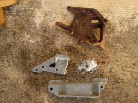

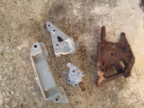

A friend left some brackets when he swapped his srt4 motor 3 times at my house. One other friend said maybe an ac bracket and power steering but can anyone identify each? pictures attached

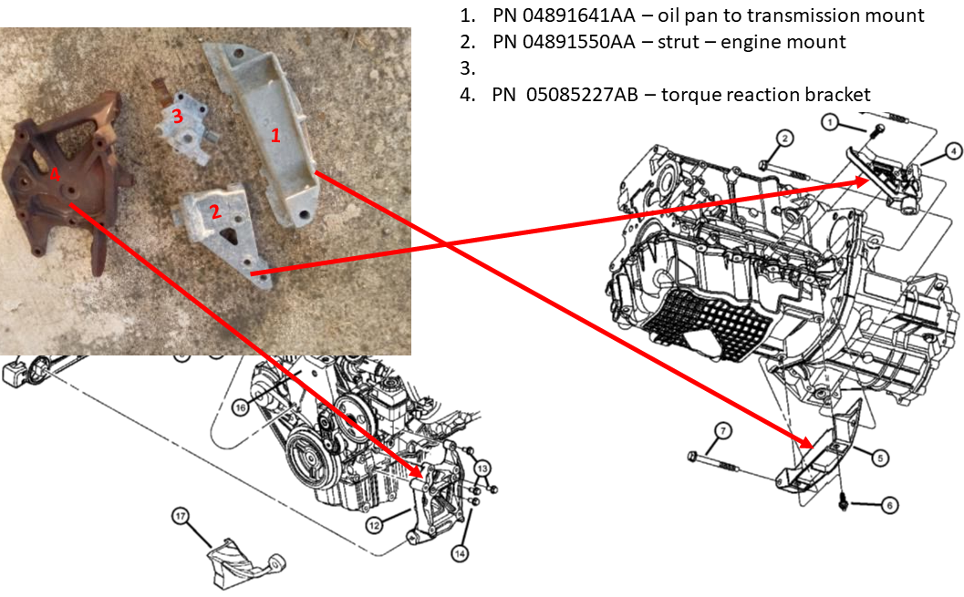

3 out of 4
Part numbers
