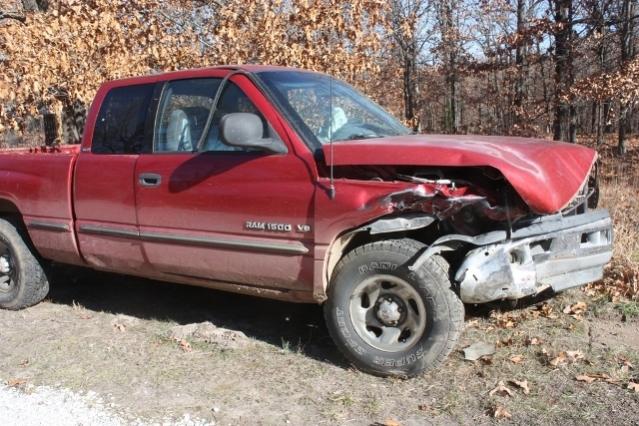

Just bought my first 4 wheel drive truck, not new to trucks just the 4 wheel drive version. Two weeks ago a man pulled out in front of me and it totaled my 98 Ram 1500 two wheel drive and I replaced it with a nicer than my old truck 97 Ram 1500 4 wheel version with almost 100,000 less miles on it. I faired much better than the Toyota or the other man driving it, I do wish him well. Long story short got a nice deal on this truck, runs and drives nice. The thing I am not sure of is when I move at very low speeds not even enough to make the speedomter to registar I get this kind of a clunk clunk noise that I think is coming from the transfer case. You can even feel it. It will speed up as I do up to a point then it just stops and makes no noise at speeds say about 5 or 6 miles pe hour. I think I get it when 4 low, 4 high 2 wheel drive. I've had the truck up on 4 jack stands and I get what I think is slack in the transfer case when I turn the drive shaft. New to for wheel drive trucks not sure how much slack should be there or what it should feel like. I can find any other nouse or anything I think is wrong by turning the front drive shaft, hubs or rerar hubs. I would like to know what to expect, what should be done and how soon. Not new to doing most things mechanical, currently doing a frame off restoration on a 68 Chevy short wide truck, but any advice would be greatly appreciated.
