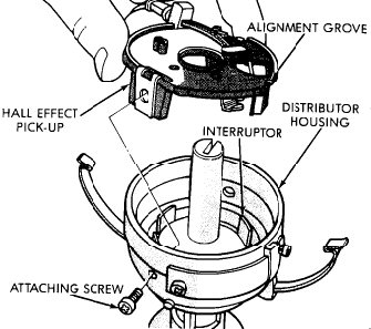

It might be a heat sensitive hall device/pickup asm in the distributor?
Attached Thumbnails Engine loses power after 2 hours of driving-hall-effect-removal.jpg
