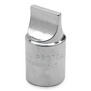

You can try this but be careful not to touch the rim. Get a few small die grinder cut off wheels and cut a slot in the extension/socket. You will probably use a few to get it so you can use a drag link socket then try to turn it.
They come in different sizes so you have to match it up.
If you get it off use a stripped lug nut/ wheel lock socket to remove the rest. There are a few different designs depending on manufacturer.
