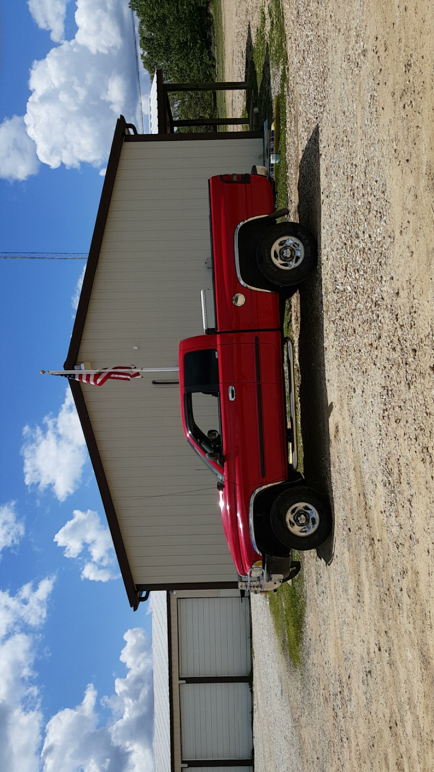

Hey everyone this will be my first post on here, just wanting to get some opinions and advice on my build for my 2000 Dodge Ram 1500 5.2L 4x4.
A little backstory my uncle bought this truck brand new in 2000, when I was about 7 or 8 and I fell in love with it. Finally 2 years ago I talked him into selling it to me Since buying it all I have done is a cat back flowmaster exhaust (my baby will wake the dead lol) transmission rebuild with transgo shift kit, and a few appearance upgrades. So other than that she is all stock. I finally got my short term build list put together and wanted some input whether it be different brands or a better route to go. So all that said heres the list.
1. Hughes Plenum kit
2. Fastman TB
3. Spectre Cold Air Intake.
4. JBA cat4ward shortie headers
5. Flowmaster direct fit cat
6. Edge Evolution CTS2 programmer
7. 180 degree thermostat.
Anyone have any input on my list and expected performance boosts? Thanks in advance!
2. Fastman TB
