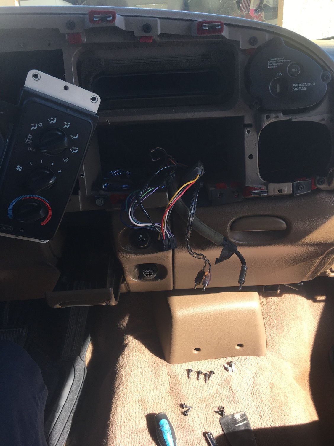

I'm working on the truck now and I can't find the leak, this thing only makes the noise when in gear and accelerating. It's coming from this area it sounds like
I checked the blend door actuator and it's not coming from behind there, and it's hard to tell where it's coming from because I can't visually see anything back there and it won't leak unless I'm accelerating in gear
I'm second guessing a vacuum leak, wouldn't it leak regardless if the truck is in gear or not? Even if I'm in gear hitting the gas it won't make a noise and I don't hear anything unless I'm actually accelerating, which the noise gets louder as the Rpms raise
