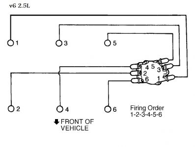

I just got back from O'Reilly's and had them pull the codes for me and was told that #4 cylinder was misfiring. Is that the cylinder on the front head or the one next to the firewall? Also, I pulled the plugs on the front head and replaced them even though they looked fine. If #4 cylinder is up front what else could the problem be?
Injector, plug wire, distributer cap, rotor, burnt valve, or worn cam. From my research, it's the center plug on the front head near the radiator. I am having the same code and my plug wire was laying on a hose clamp and may have been shorting. Check wire and see if it is shorting on some metal..
