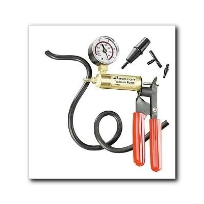

Lol, sorry, I meant a handheld vacuum test, like this one.
Which manifold? There's two, the upper (the one the normally referred to as the intake) and then the lower (sight unseen). Both have gaskets that can be seated improperly. Who did the work? A shop or you? If you did it, did you clean the area where the gasket sits? The throttle body has a shaft and seals that can go bad too (the seals), not to mention the BISS (4g63) or Base Idle Set Screw o-ring (if you have one).

where can i get the pump and how much also a shop did the work and im guessing it was the top manifold and i can really take apart anything right now because im at school and no tools ironicly im at a school with an automotive program but dont have the classes yet lol so im thinkin of just starting with the vacumm lines
