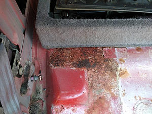

I finally got a decent day outside although those will be few from now on. When I got this truck I noticed a definite interior musty smell and stained areas on the carpet where it looked like there had been standing water to some degree. When I got it back to the house I completely vacuumed it out and got everything off the floor in order to let it ventilate and perhaps dry out. I was hoping that this wasn't pointing to a particular leak but now I'm not sure.
Looks to me like it's been leaking quite a while, the rust under the driver side carpet is pretty bad but not through, which is fine in my book.

It's not the weatherstrip itself that's failed it's the metal crimp portion that's bad along the bottom edge. The water is getting in by flowing over the lower pinch weld flange where the weatherstrip is no longer tight. I'm almost thinking that the new should have a bead of silicone applied into the U channel at the bottom of the door opening.
As for the quarter glass it seems that the weatherstrip just has no more resilience, water is entering at the top and running down the glass and pooling at the behind the interior panel, then runs down the alongside the speaker to the floor.
I'm going to have to por-15 the driver floor at the very least. The good thing though is I don't see any holes.
