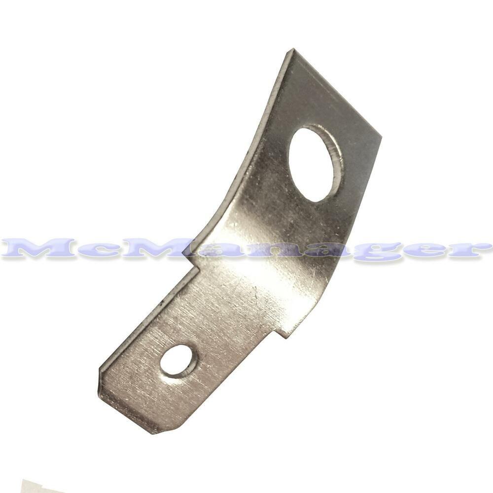

On the 2 smaller terminals, could you use something like this in the picture below? And if so, are you sure your old alternator does not have these already, and you just need to move to the new one?
