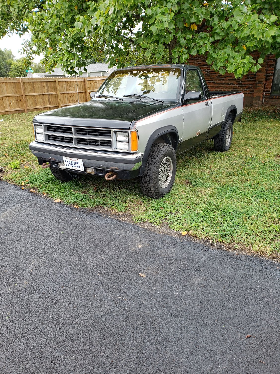

New guy here. I have seen a couple post on tank swaps. There are 3 late 80's in a bone yard near me, and all have the same problem. Rusted sending units. I found a 94 Dakota 22 gallon tank but is uses a fuel pump module. Has anyone tried this sawp?

Thanks for the info. I was thinking of trying to put the TBI pump in the 94 module. By pass the regulator made into the module. Was hoping for an easier way. The owner said to get it out of his driveway I could have it. To nice to pass up. Benn sitting 14 years.

I did grab the tank. My truck had the small tank, and it had a big split in the top. I guess from age. The ones in the boneyard had 1/2 inch holes drilled in them. Good ol EPA requirements for the yards.
