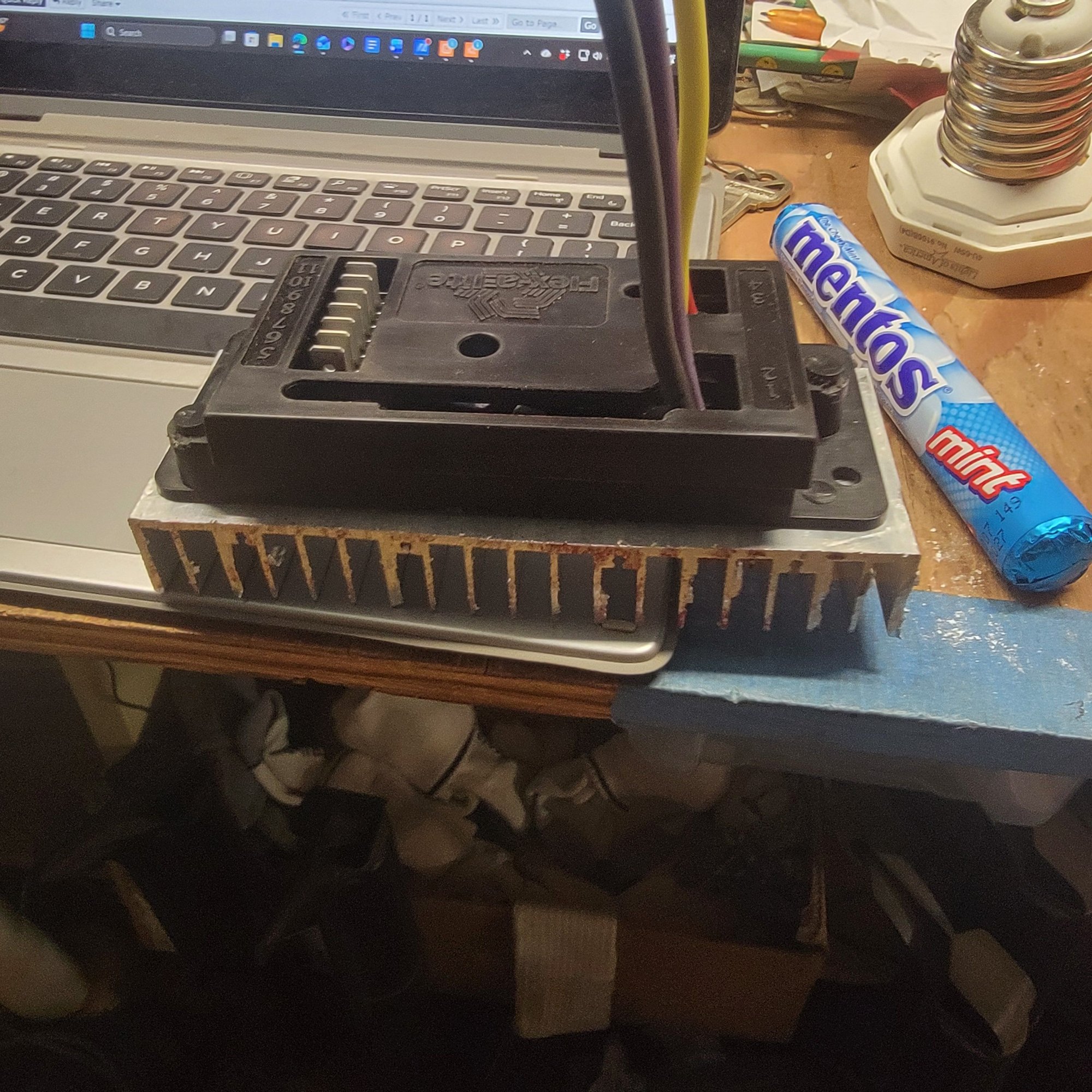

I have a Flex-a-lite controller. Flexlite offers replacement controllers on threr web site. To me, that shows a short expected lifetime. On mine, I'm going to try gluing the controller to an Aluminum heatsink(heat transfer glue) and maybe mount it somewhere away from the engine heat. In front of the radiator? uumm, water! In a sealed box, next to the headlites. Some of you will know this, I've been away from the electronic end for a while, and this is a nice refresher.
The smog tech mechanic said that he programmed a Raspberry Pi to control his fans. He was melting relays, so he's running 2 in parallel. Then, he saw my 200A contactor, and he said, maybe, that's what I need! It was only 50 bucks and in 5 years hasn't melted. Does make a BIG clunk.
Dont have any glue yet, instead some heat transfer paste and bolt it together?
Don't have any glue yet, instead some heat transfer paste and bolt it together?

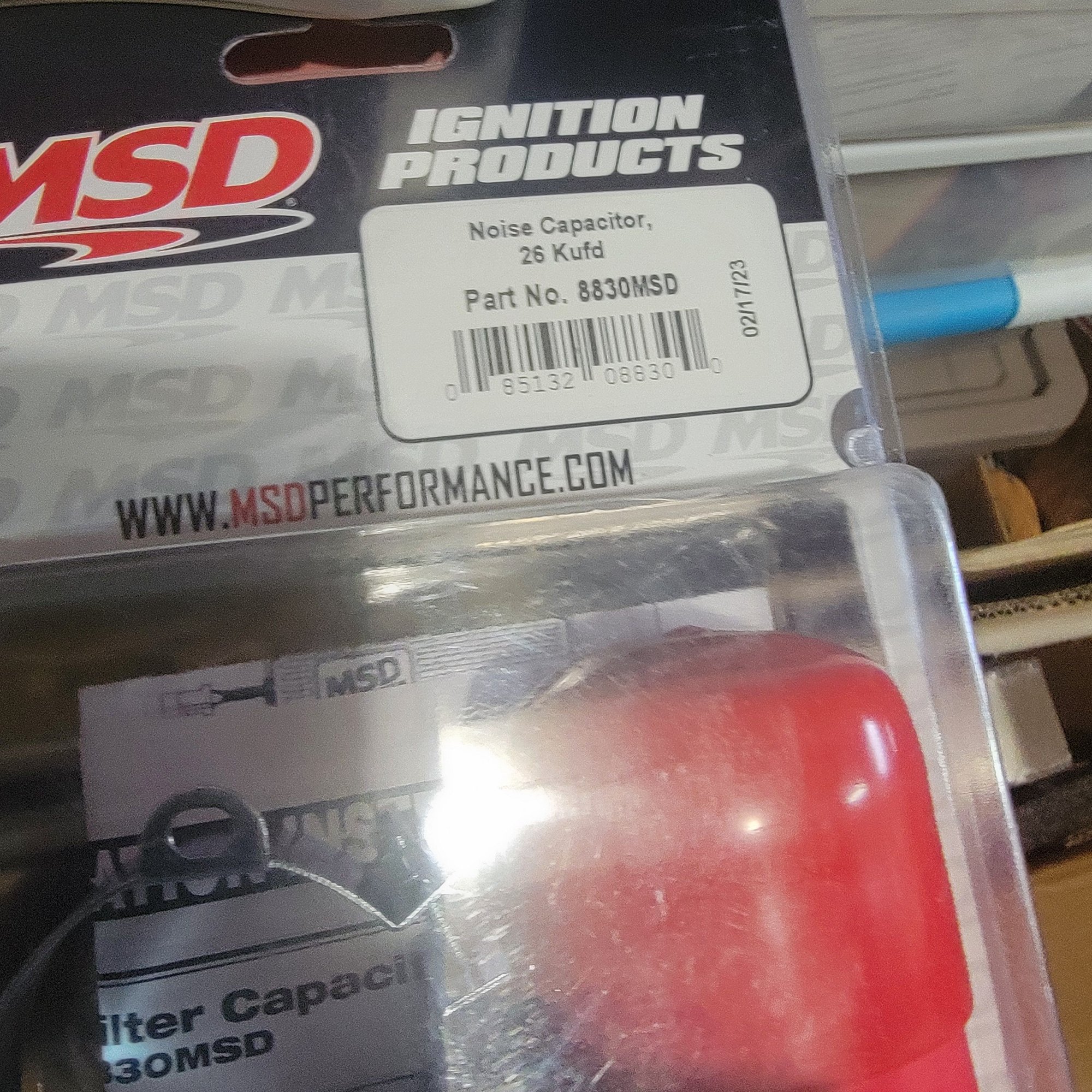

Here is the MSD 26Kmfd Ignition noise electrolytic capacitor. (Electrolytic means Polerized) They recommend installing it within 6 in of their spark box, across the power wires. Positive to Positive, Negative to Negative. The top of the Cap is marked Pos & Neg. Then they say to make sure all of your ignition is up to snuff. And all the grounds, clean terminals, etc... They write that's 2 types of noise, 1 that comes thru the antenna, and the other is thru the wires. If you hear it in the tape/disc player and the radio, its thru the wires. If just the radio, it's the antenna. Keep the ignition sources away from the antenna.
Maybe put a Faraday cage around the engine? How about those guys running a booster on their CB radios? If you have a different idea or way, post it
26Kmfd, 26,000 mfd? part# 8830MSD, actually it doesnt show the voltage its used with. Sometimes for a nomally 12v system the cap will be rated at 25+vdc?
