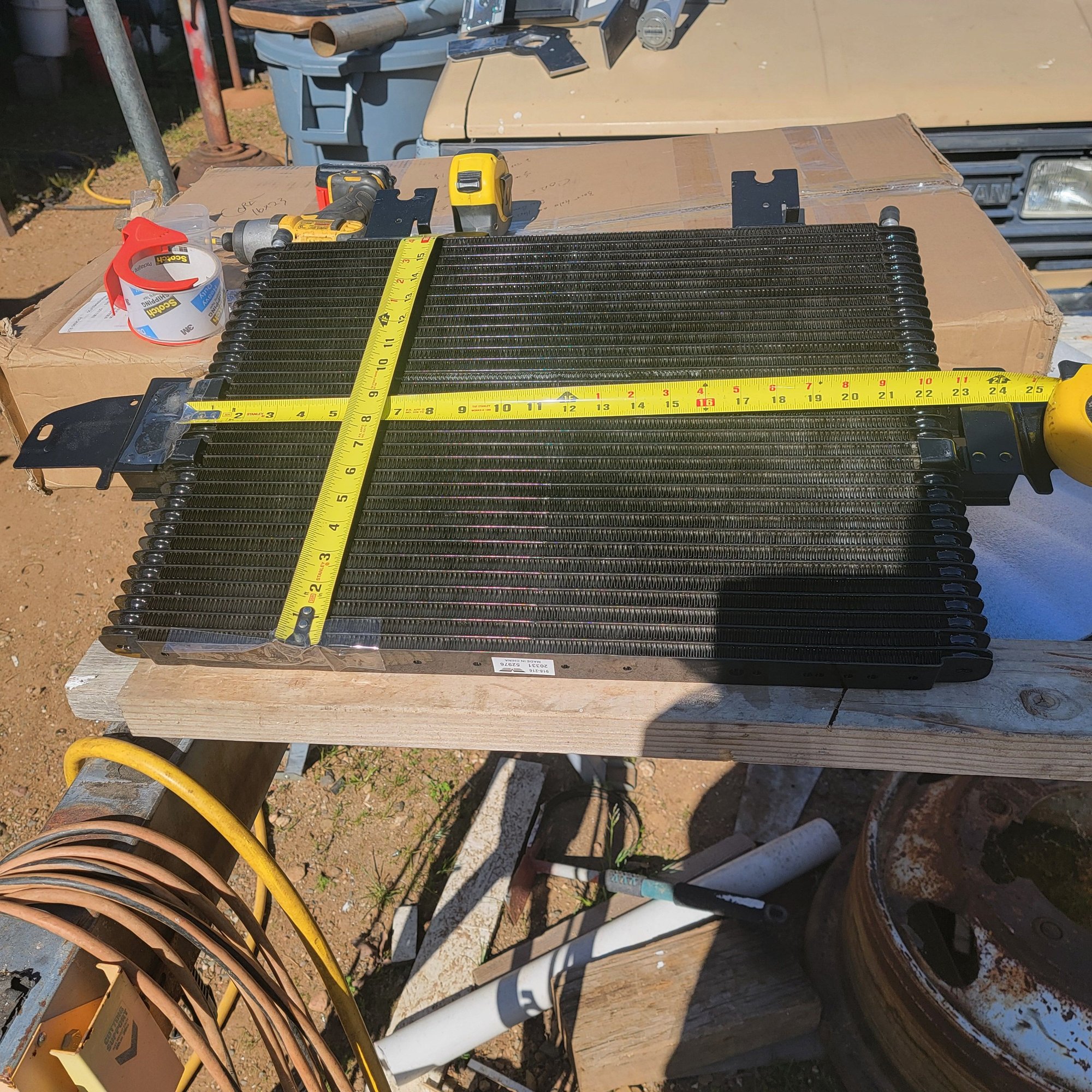

If I moved the exhaust , I probably wont have room for this
its 17x23 and uses barbed connections, I was hoping to use hardline from Transmission to the cooler. It will depend on how much vibration and movement between the tranny and cooler. If its a short distance like crossing to the frame, then I would use a crimped on hose. If the tranny will move more than a 1/4 in then it will probably need a flexible join.
its 17x23 and uses barbed connections, I was hoping to use hardline from Transmission to the cooler. It will depend on how much vibration and movement between the tranny and cooler. If it's a short distance like crossing to the frame, then I would use a crimped on hose. If the tranny will move more than a 1/4 in then it will probably need a flexible join.

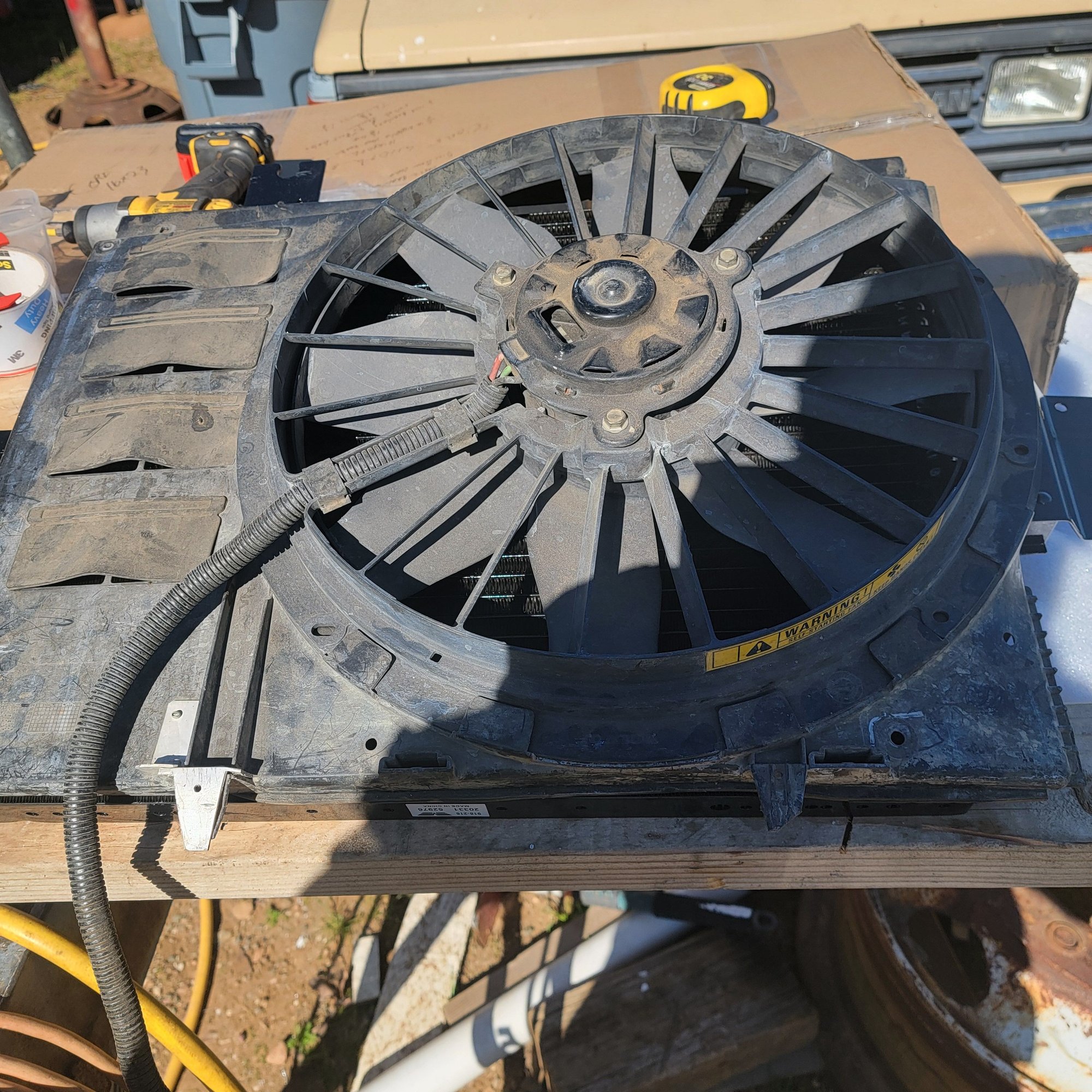

this fan is from a 93 volvo 960, I think its 2 speed, it covers that whole thing. but, I think, Ill be out of room under the bed. probably have to leave it in front of  the radiator. where one of these is residing now.
this fan is from a 93 volvo 960, I think its 2 speed, it covers that whole thing. but, I think, I'll be out of room under the bed. probably have to leave it in front of the radiator. where one of these is residing now.
