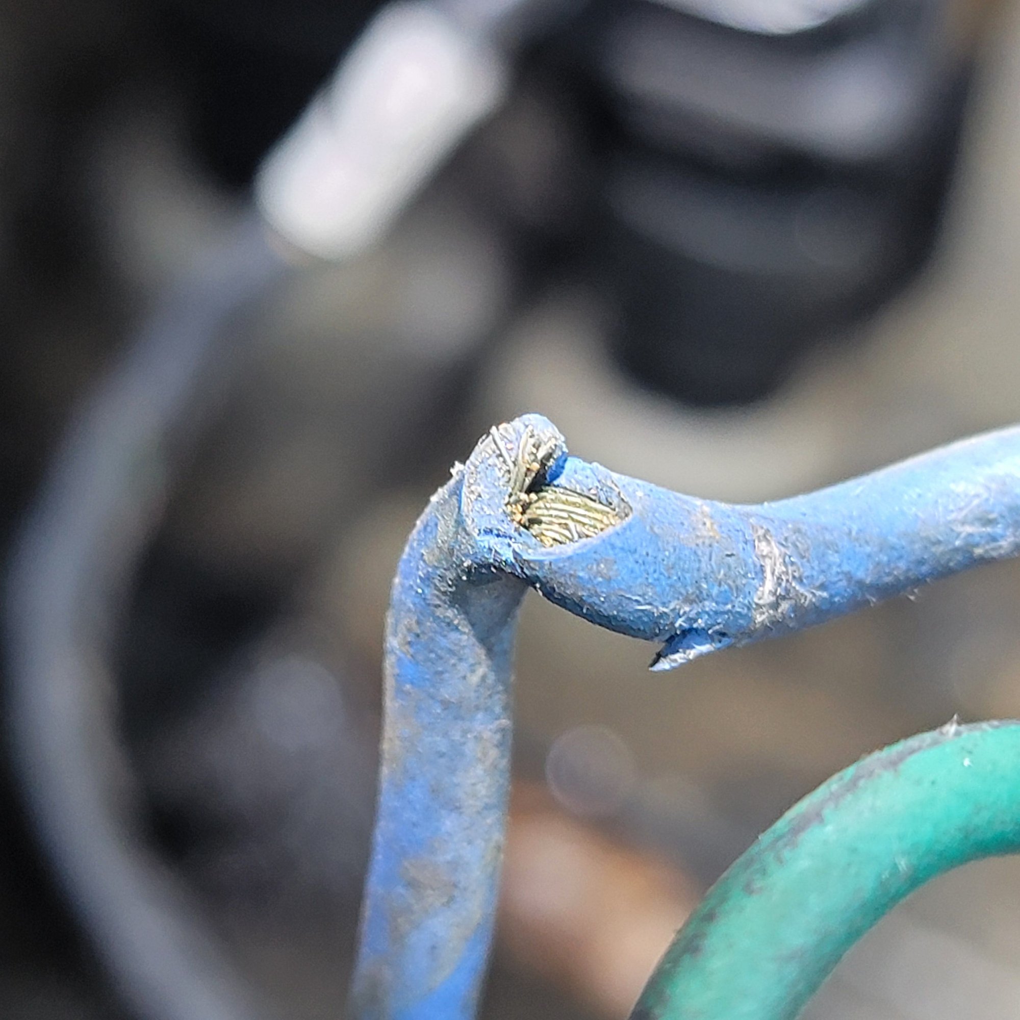

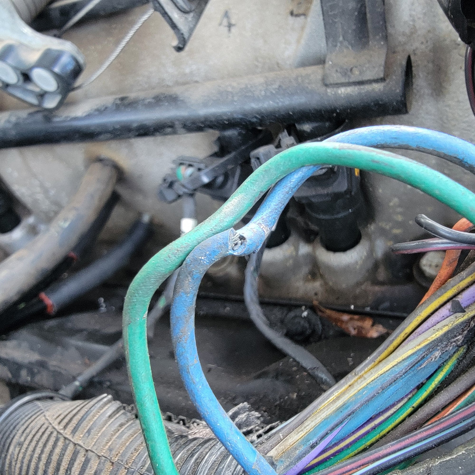

I read one of the posts about someone having a little trouble with their charging system.
On my 94 Dakota, 4x4,auto, etc... I was cleaning the main charge wire on the alternator, when I gently moved the field wires out of the way, I noticed this
And this is a blow up,
Where one of the previous owners, mechanic was checking for power ? Whom ever almost severed the wire. Then I noticed this----->
Where one of the previous owners', mechanic, was checking for power ? Whom ever almost severed the wire. Then I noticed this----->

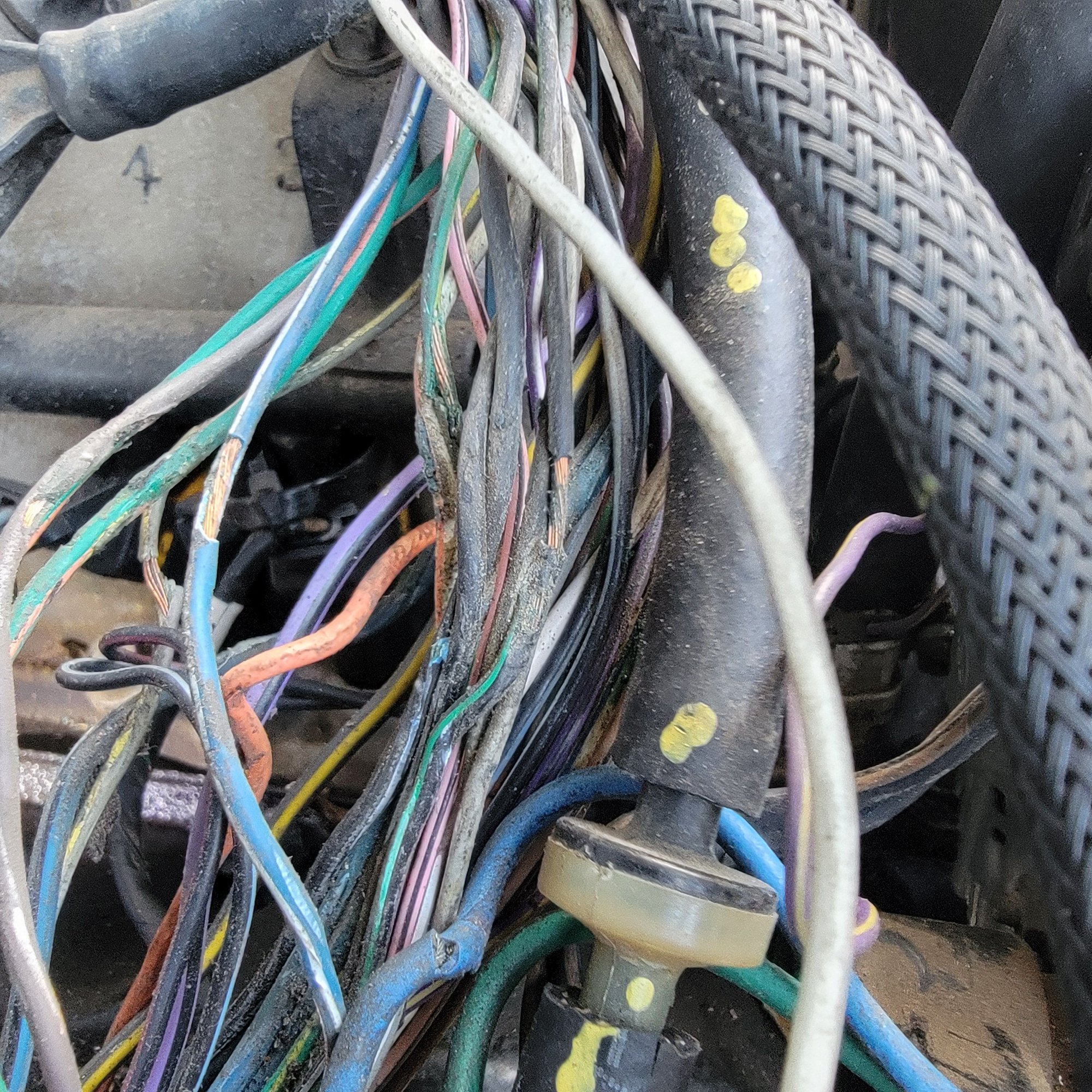

It looks like half the wire bundle has thier plastic jackets molded to gether. Besides the bare wires?
It looks like half the wire bundle has thier plastic jackets molded to gether. Besides the bare wires? I guess I know what I'll be doing for the next several hours. It's already 6:21 PM PST. I missed some sleep last night(well, I only got about 3 hrs) So maybe this is a tomorrow job. Ha, Ha! DONT need an engine fire!

Yep, I see some wires that got hot, and melted, definitely need to fix that.

When I bought this hunk of love, that wire bundle was sandwiched between the intake and the Alternator and A/C compressor. I pulled it up on top of the intake about last September, then for 1st time the temp gauge would register the engine warming. I didn't pay it any mind till I looked at the power wire coming out of the alternator. Now I have found some of the wires on the driver's side have melted. Well, actually, the wires are fine; it's the insulation that melted together. I haven't found any wires melted or broken. I guess the only reason it didn't short out was because of the plastic wire protector.
Some of the wires need to be replaced from one side to the other. Mostly, I just cut and crimp back together, removing a short piece of wire. I've pulled both sides of the loom apart, looking for some slack. I have to remember to slide a piece of heatshrink on before I crimp the other end. Someone must of distracted me a couple of times.
I haven't soldered wires together for quite a while, so I cheated a little and used crimp splices.

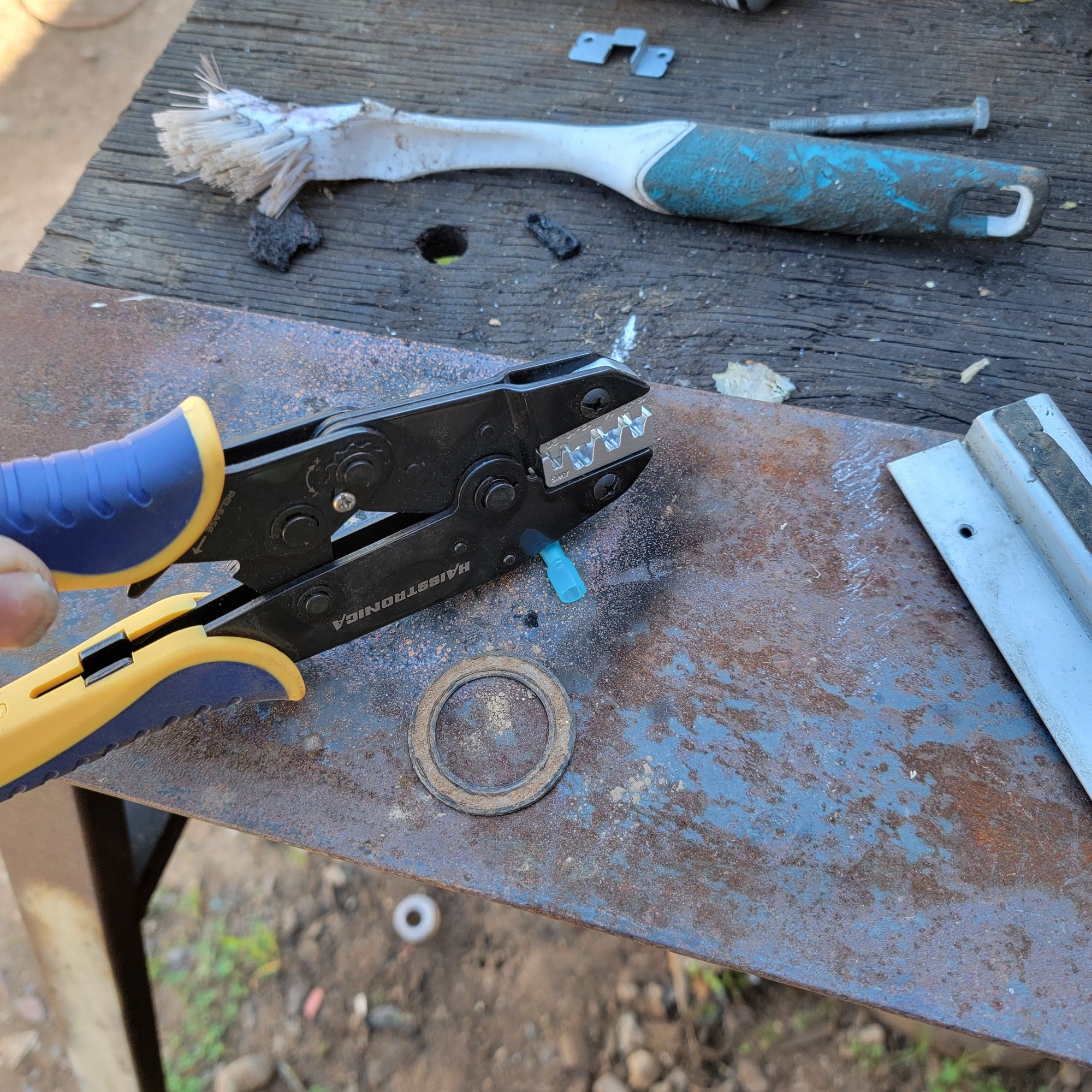

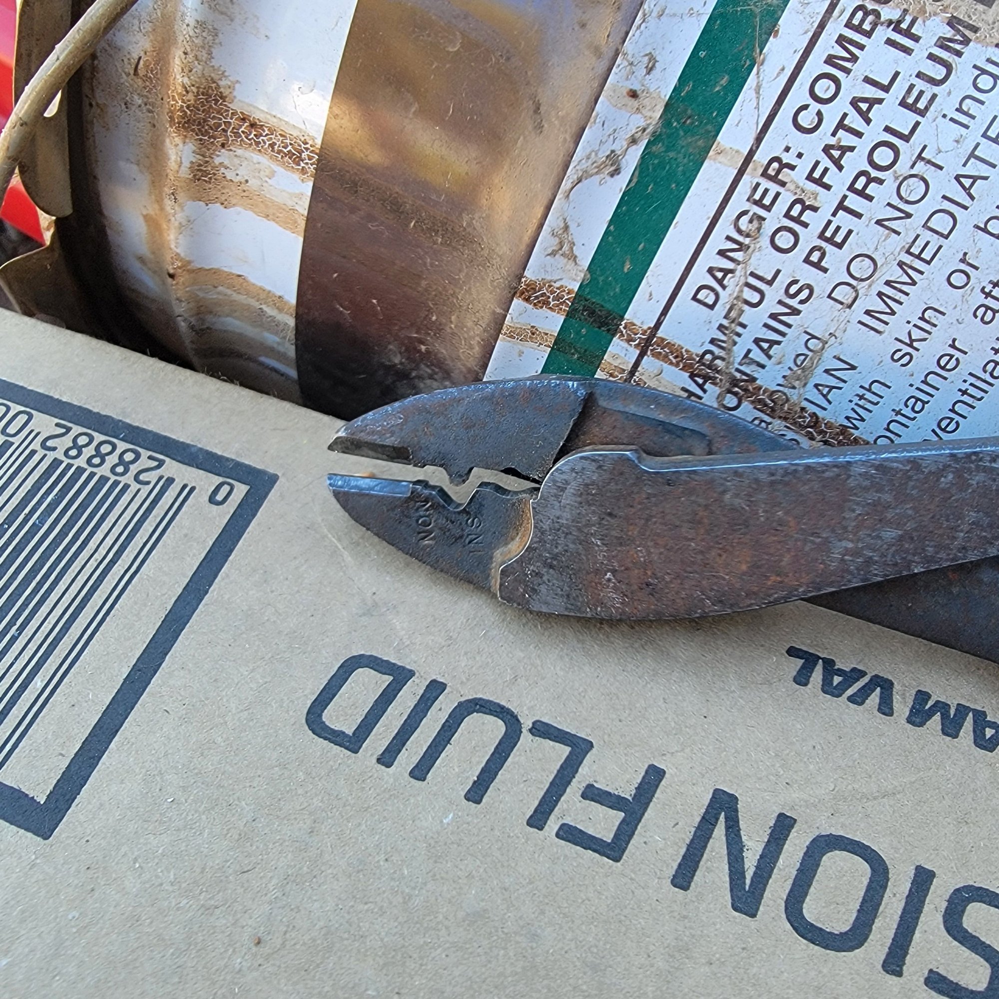

I've done a lot of soldered and crimped connections. Crimp wins hands down for simplicity, ease of use and time. I've used a TDR to find broken wires, a crimp connection will always show a return blip, and very seldom will a solder joint show anything. A soldered joint will normally have lower resistance than a crimped connection. If the wire is properly supported, so it can't flex much,
I have several types of crimpers, ratchet type and the other type, Oh, Yeah, Its that other type !!
Ive used this type since the 80s.
I've used this type since the 80s.
I cant figure this type out, I keep smacking the crimp but it doesnt crimp very good. Maybe a case of old dog cant learn new tricks?
I cant figure this type out, I keep smacking the crimp but it doesn't crimp very good. Maybe a case of old dog can't learn new tricks?

I'm OK with crimped ends ... if the new tool is not working as expected, I would go back to the old school crimp.
I always thought solder and shrink tube is best .... and listening to others arguments, I'm now a confirmed crimper
First thing, airplanes who have the strictest safety standards while being built .... must have crimped fittings for 2 reasons. .... probably a lot more ... 2 are good enough for me.
1, solder wire connection may look good ... they can not actually test it.
2, the solder wire creates a rigid connection on the soft flexible wire .... with extended hours of vibration, the rigid solder can start to crack and actually break off.
What the aerospace industry requires is a hydraulic type crimp tool that basically guarantees a quality specked crimp every time ... not cheap for a average user.
I use a old school crimp tool ... I always remove the plastic covers on the connectors if they have one.
Would be easier to buy connectors without them ... the ones I have found are too thin and cheap, I will not use them. So I strip the covers off.
Then when I crimp, I crimp straight down to lock it in place ... you look at the sides and there is a gap ... so I turn it sideways and crimp it down and tighten it up ... turn it back and straight down again ... usually that is enough.
But I tug on it and inspect it ... and crimp it some more until I'm satisfied with it ... then slide over the shrink tube and finish it off.

In the 1980s, NavAir had specified that soldering was preferred when properly secured. It was accepted to use a crimped connection. (Since then it might have changed) There were a lot of places that had to be soldered, no room for a crimp or crimper. We did a lot of crimping and soldering, roughly 40/60. We didn't have a hydraulic press, but we did have a nico press for crimping #6 wires. About 20% of the gripes were caused by a broken wire, (broke inside the insulation) a recessed pin or a crimped connection failing. We never had a soldered connection fail. Of course, any time you allow the wire to vibrate, as in movement, too much, it will fail. Through work hardening if nothing else. When I mentioned the wire was properly secured, it was against plus or minus 10+ Gs, multiple times per flight, multiple times per day. The vibrations aren't small vibrations.
I've found more bad crimped joints than soldered joints. If it's really bad, it will drop enough voltage to be found with a DVOM. Like where a crimped joint wasn't sealed, and moisture/acids permeate the joint. The stuff migrates down the wire strands and past or under the heat shrink to the crimp, and sometimes solder seals it out.
That crimper I use, I have to be really careful not to make a hole in the crimp sleeve covering. Which then I have to patch. I was crimping some # 20 wires today and that crimper doesn't go small enough. A pair of vise grips worked.

When you suggest your crimp tool did not fork well on 20 gauge wire, but vice grips did ..... you're paying attention.
