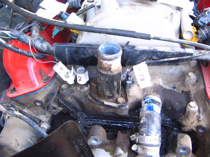

Anybody know what number 9 is? And if #9 is the coolant temp sensor then what is number 13?

Both 9 and 13 are coolent sensors. 9 is for the guage. 13 is for the computer.

both the same sensor huh alright I will go to kragen a get a coolant sensor.I ask all this cause I broke #9 tryin to take it off with a piece still in the manifold. thx crazy
