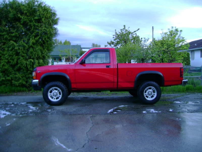

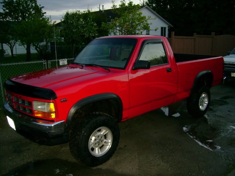

Yeah if you're just straight up slapping the blocks into a 4x4 you need squared bolts. Or you can flip them them, but you need 2wd plates because4x4's arespring overand 4x2's are spring under. And my truck:
That's with Durango rims and 31x9.5" rubber.
