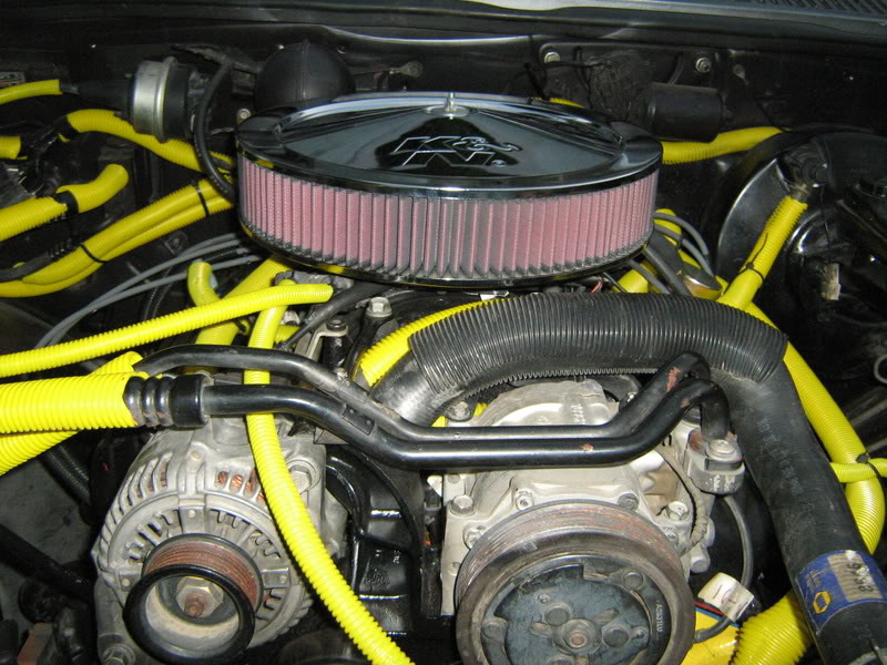

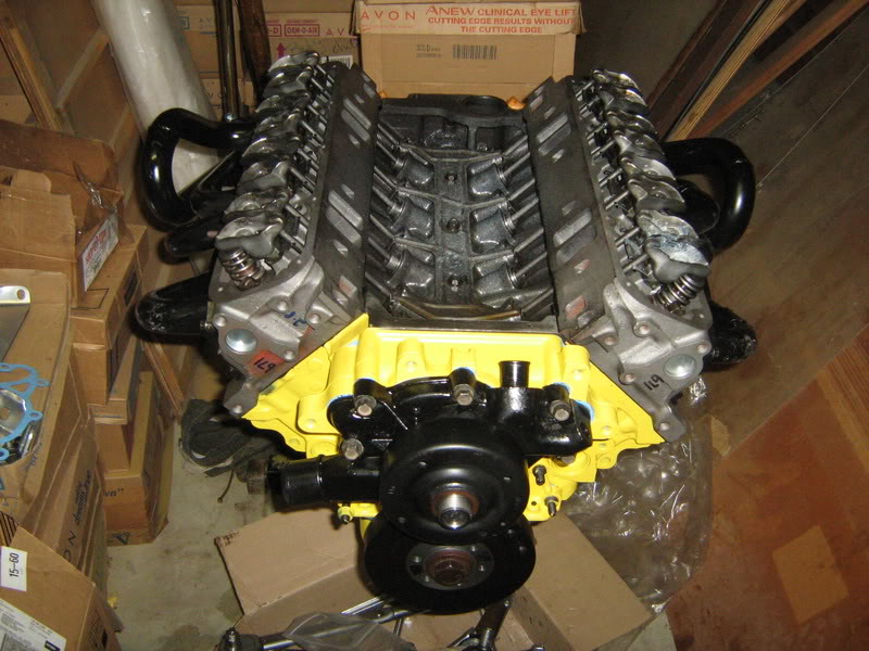

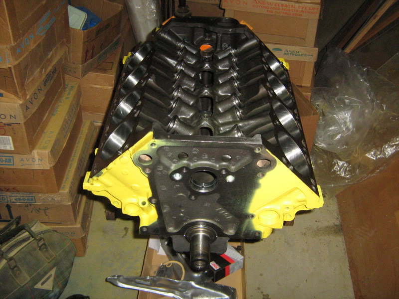

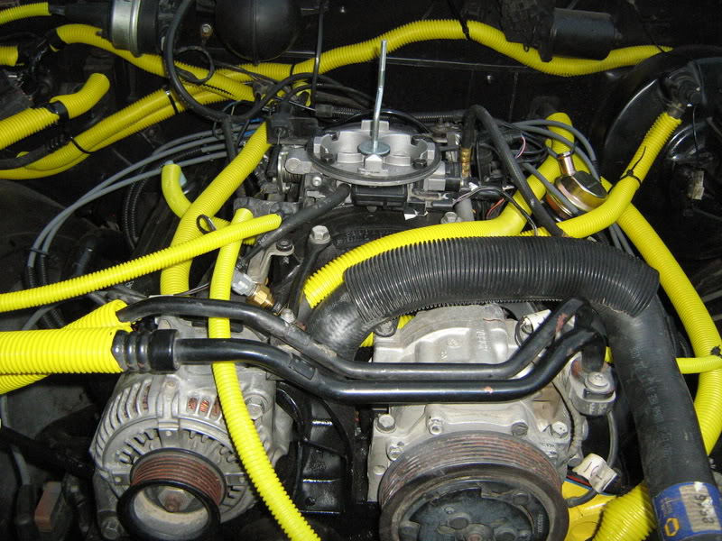

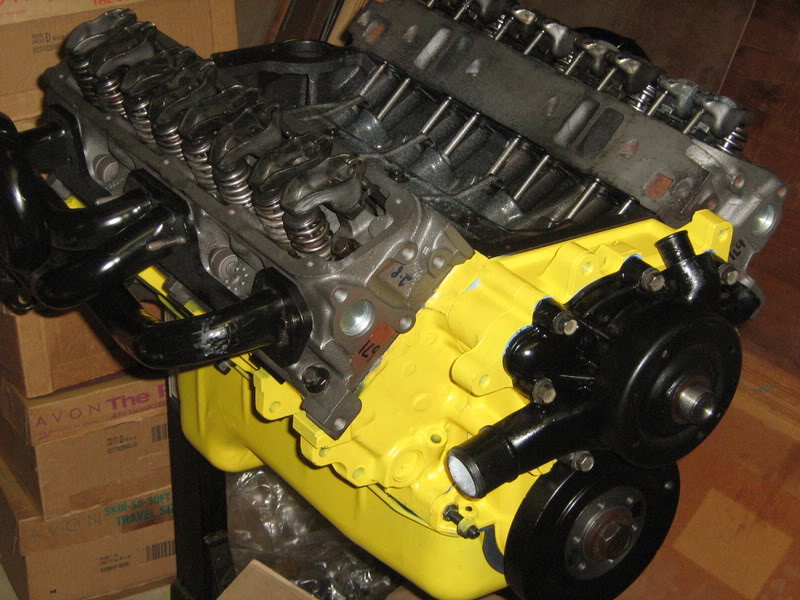

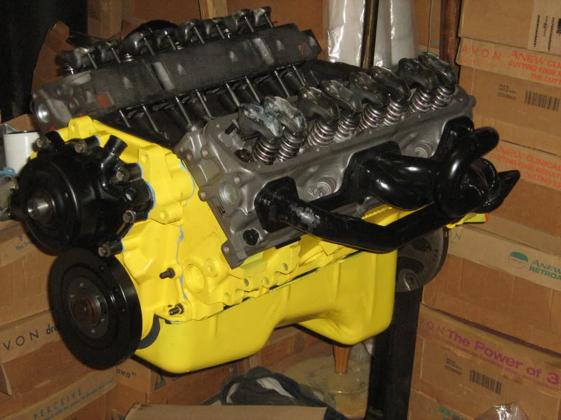

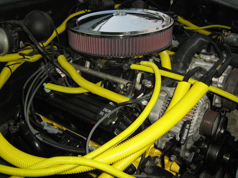

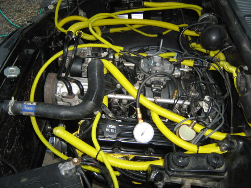

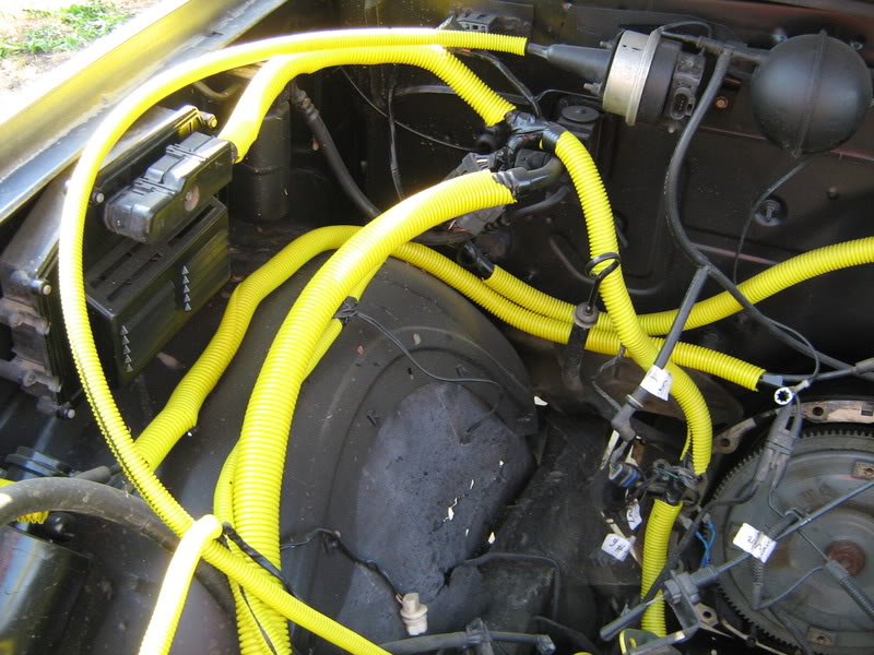

Well been workin on my Super bee magnumengine more lately and its almost finished should have it in maybe by this weekend or next but heres couple before and after pics. Only things I still need to do are paint my heads, finish all my wiring looms,and get the oil priming tool or make my own. I will post more pictures to come
Before
After

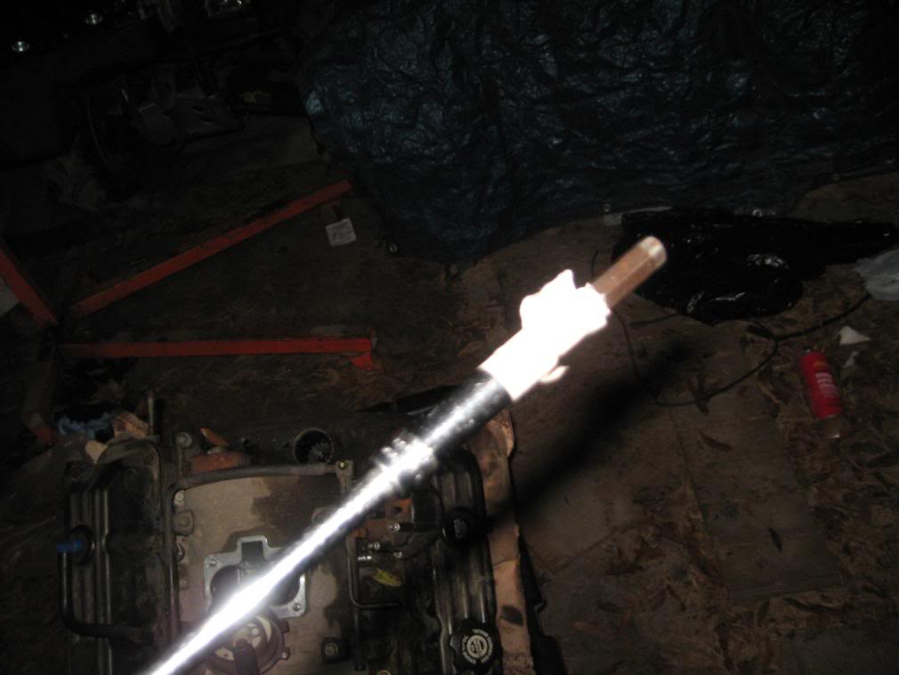

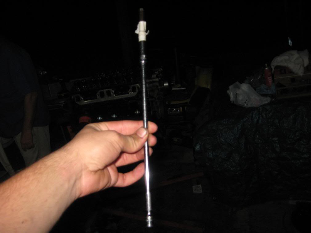

looks good, makes me wish i painted my engine! here are some pictures of my homemade priming tool
it is a 7mm allen taped to a 7mm deep socket. pretty getto but it works really good!!!

[sm=redxX.gif][sm=redx.gif]what did you make yours out of?

it was a 7mm 3/8 drive socket but it would not fit in there so i pulled the allen out and tabed it to a 7mm 1/4 inch drive socket and a long extension. worked like a charm, just used a regular drill, just remember to put the oil sending unit in or it will be like old faithful!

Ok got it in, all connections made, oil system primed, fuel pump working, and green lights across the board.
Ok time to start it up!
http://s82.photobucket.com/albums/j2...t=MVI_2866.flv
hmmmmm

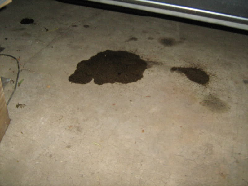

LOL DAMN fuel leak!!!
It started leakin right after the filter so I got some 3/8hose and replaced it and tried again well this time the fuel connections at the fuel railblew off!![:@]No damage done just little bit of gas on the motor I knew I should of connected them instead of lettin my dad do it[8D]So being it was 1:30am last that this all happened i quit and gonna try again today and I will post the video once I get a chance.
