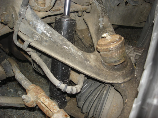

I am wondering if this situation is bad or not. I have been driving with this "ball joint cover"? loose for a couple days now and it seems to drive fine, a little clunking every now and then. As you can see in the pic, the threads on this part seem stripped. does this part thread into the hole ? or does it just fit in . I banged on it with a hammer and it does not want to budge much. Do I need to loosen my ball joint and/or control-arm or take it off to get this part back in ? The nut on the bottom seems tight with the pin still in.

the upper ball joints are screw in on these trucks and if that has falllen out it is not cool to drive it!!! a pic would help to see what you are talking about

http://lh5.ggpht.com/WiredAmerican/S...JPG?imgmax=512
Here is a link to the pic with the fallen out part.

your ball joint fell out!!! that is not a good idea to drive until you get is fixed, very bad things can happen!!! i would go ahead and get the rest of them done whille you are in there...

that's unsafe to drive! i stripped one of mine (not severly though) changing my upper balljoints last month. put some locktight red on it and tack welded it in. i had an 88 for parts and noticed someone had welded that one in too. you sould probably replace the upper control arm if you plan on keeping it for a while, mine is headed for the bone yard soon so i'm not worried if the joint goes.

The same thing happened to me about a month ago. I was coming home from work and the truck got loose on me, when i got it home i looked under it and the ball joint had popped out. I had to replace the upper control arm cause there werent enough of the threads left to put the ball joint back in.
