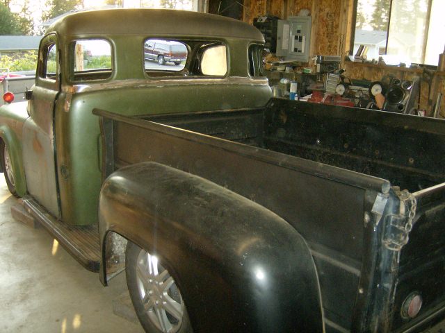

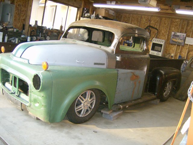

So if I understand you correctly, my 1968 318 will fit into my 91 dakota chassis with only an oil pan change? It had the 5.2 liter motor in it. the motor mounts will be the same for the 1968 motor? the frame now holds a 53 Dodge truck body.

Ya correct! Show us some pics of the 53 Dodge!

Here ya go, I hesitated to post a pic, your post says no truck should be lowered... ever.... Mine can't get any lower than it is. So I can go to my local NAPA and get new motor mounts for a 1991 Dakota 5.2 liter and they should bolt right up? I didn't believe it would be that easy! Bud
