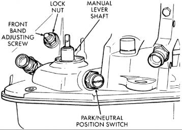

- Raise and support vehicle, then loosen band adjusting screw locknut, Fig. 6.
- Back locknut out three to five turns, ensuring adjusting screw rotates freely in transmission case. Use suitable lubricant on threads, if necessary.
- Use a 0-100 in.lb. torque wrench to set adjusting screw. A 5/16 in.12 point socket , or crowfoot wrench will be required to turn adjusting screw. CAUTION: If adapter extension C-3705 must be used to reach adjuster screw, tighten screw to only 5 N.m (47-50 in.lb.) torque.
- Tighten band adjusting screw to 8 N.m (72 in.lbs.) , then back screw as follows:
- On 32RH-42RH, back off adjusting screw 2-1/4 turns.
- On 36RH/37R-46RH, back off adjusting screw 2-7/8 turns.
- On 47RH, back off adjusting screw 1-7/8 turns.
- Hold adjusting screw in position and tighten locknut to 41 N.m (30 ft.lbs.) torque, then lower vehicle.
