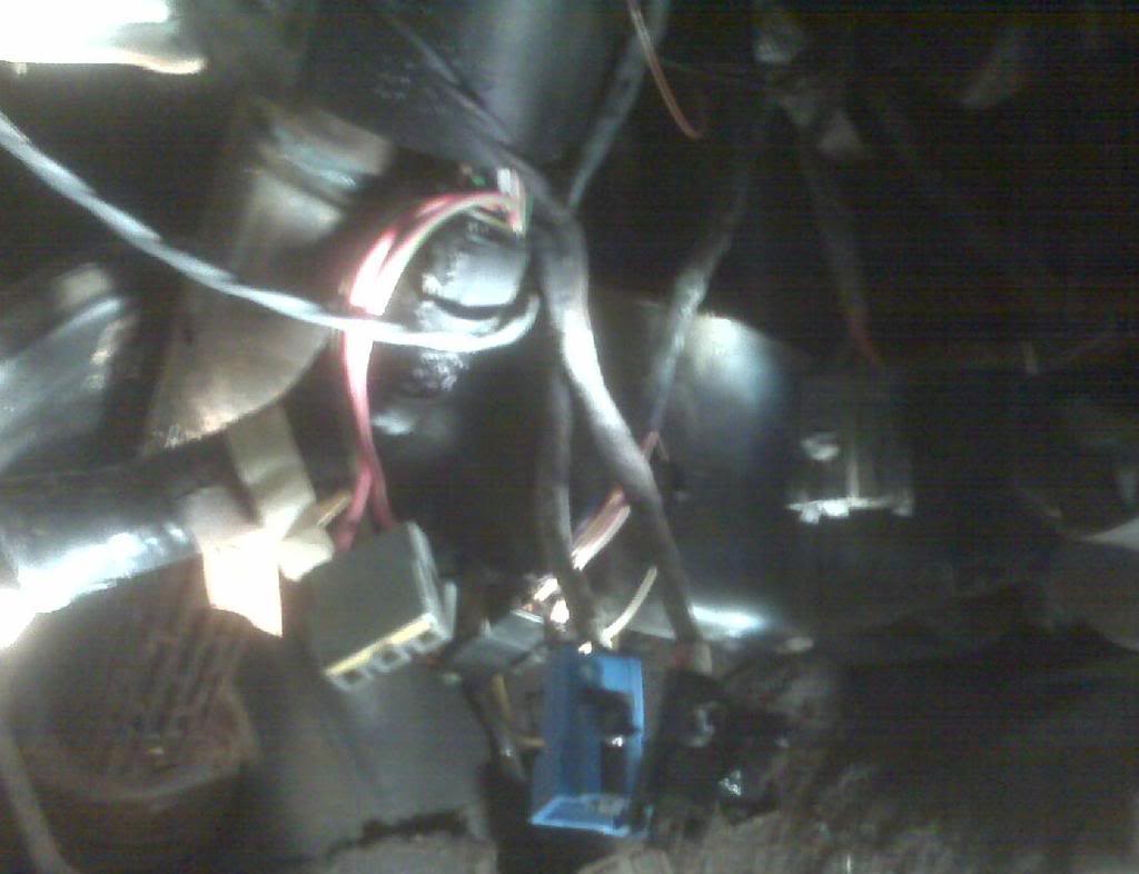

I had some success so far but Im still having some issues. I removed the alarm system and patched up the wiring, which fixed the power door locks, but my radio still doesnt work. neither does the cig lighter or dome lights. my thermometer and compass work, and the dash lights up. there are some connectors under the steering wheel that dont plug into anything though. what are these 4 connectors for?
thx!

Blue12 I have those same connectors unconnected. Those are probably for some other options we dont have like daytime lights factory electric fans or something like that.
Thanks to 408Ram we have a great new wiring diagram for a 94 dakota. To download go to http://rapidshare.com/files/15954448...omplete_1_.pdf Click free user. I posted this in the FAQ.

good to know, ill start tracing wires to see if i have a short or broken connection. i wouldnt be suprised... the last owner didnt take great care of it
