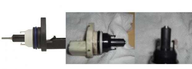

Default Replaced Transmission Speed Sensor
I have a 1995 Dakota Sport 5.2 and the same thing happened to me. No speedometer, no odometer and shifted rough. Here's what my transmission speed sensor looked like and what it should look like. Notice the tip on the new one and the lack of a sensor tip on the old one. After replacing with AZ part #SU394 everything is working as it should. You will need to rewire the wiring harness with the wires and harness that come with the sensor. It's a very easy fix and can be done in less than 30 minutes.
I know this is a old thread but is mine the only one with a actual speedo Geer on the speed sensor?
No; ALL of the 1st Gen Dakotas have one.
The difference is that starting with 1994, the VSS is what drove the speedometer, not a cable.
