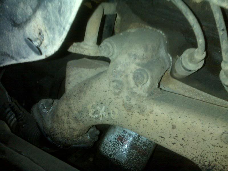

the line from the gas tank to the canister is mia lol, and a lot of stuff wont last much longer. so instead of fixing it, i just want to get rid of everything.
also, this truck used to have headers the po said one side leaked so he put stock manifolds back on, (and i actually have one good header that needs a partner as he trashed the bad one) but im not sure if he did it right. is this part of the egr system? if it is, its not doing much now anyway lol. im not too familar with this stuff, and my haynes manual doesnt go into great detail on it

Yes that pipe is for the EGR. And looks like that exhaust manifold is from a 97-up v8. So it doesn't have the holes drilled out for the EGR.
so thats why my 88 3.9 has a hole in the exhaust manifold. I could tell that it originally had all the egr crap and whoever owned it before me just threw all that crap out.

Whats all that black stuff splattered all over your manifold/oil filter?
