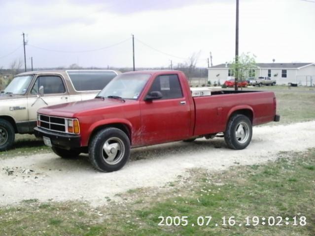

Ok, I have a 1987 3.9L Dakota with 68,000k, AT, Bad AC, 2wd, regular cab, short bed. I recently changed the water pump and all the front side gaskets, then the intake gasket blew. I changed that, it runs great. but the thermostat does not open until the temp needle gets half way up. Then it drops and runs fine. After replaceing the thermostat, The same thing happens.
I have read the post about "burping" and I have filled radiators before. Did I really get two bad thermostats in a row, with the same problem? or am I doing it wrong?
