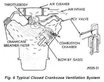

I've always wondered why its only on one bank, what about getting the fumes out of the other bank?
Old Apr 8, 2009 | 09:11 PM
dodgerules86's Avatar
dodgerules86
Joined: Dec 2003
Posts: 4,119
From: Sycamore, Illinois (displaced to Arkansas)
Here's a pic from the service manual.

Huh, maybe I would be better off to leave that alone.

The PCV valve (right side of the 3.9/5.2) lets fresh air from the intake into the engine and the breather (drivers side) lets dirty air into the bottom of the air cleaner to be burnt in the engine. You can eliminate the hose by just letting the dirty air vent into the engine compartment with a cheap Auto Zone breather filter. If you really want to keep the ugly rubber hose Edelbrock has a kit you can buy at most parts stores part #4207 or 4221 i don't remember which one is for the right size hose.
