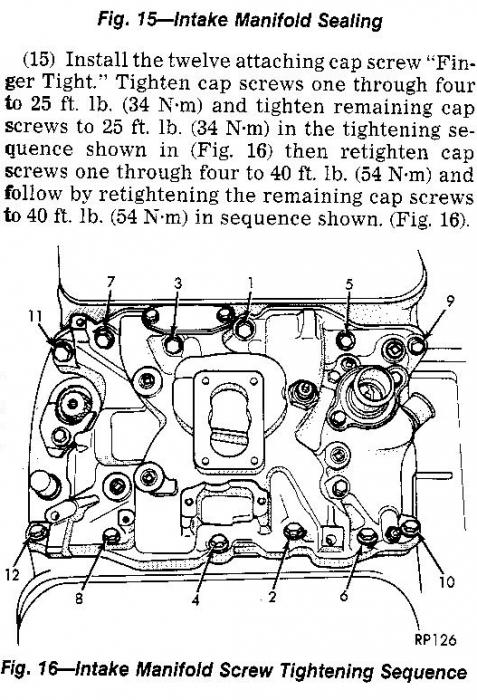

here tell me if this helps, my engine is the 3.9L carburated so its not the same but the tourqe specs should be?

k well, i dug around the house, and found my haynes manual, i didnt know where it was, thats why i figured it would be easier for me to ask on here, but this doesnt look like its gunna be fun, but at least i will only have to do this once! BUT, this will have to be a project for monday, i need my truck this weekend, so.. and im also gunna do a write up on the plenum fix so that i may be able to make it easier for someone else to do it. its gunna be fun....
