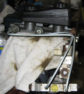

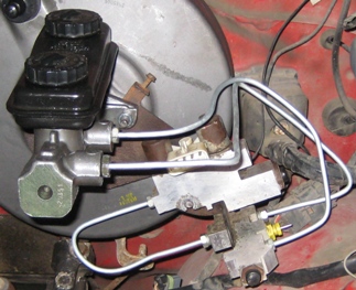

Got any pictures of the lines on the truck?

Pictures, all that's missing now is the lines going out to the wheels.
