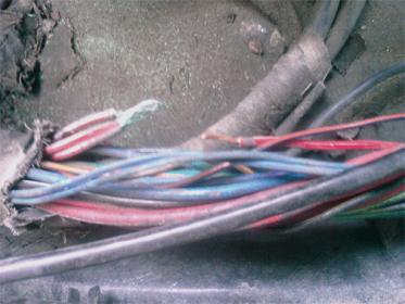

I think the splice they're talking about is the one underneath the PDC under the hood. The are a few bolts that hold the PDC onto the fender. Unbolt it and lift it up. You will see a thick bundle of wires that run below it. There is where you will find the infamous splice that goes bad. You may have to remove some of the tape that bundles the wires but it's there, and for gods sake please be sure that the battery is disconnected before you start this venture. Hope this picture helps, this is what I found when my '95 wouldn't start.
