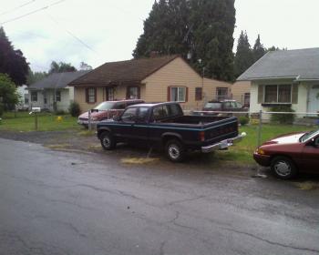

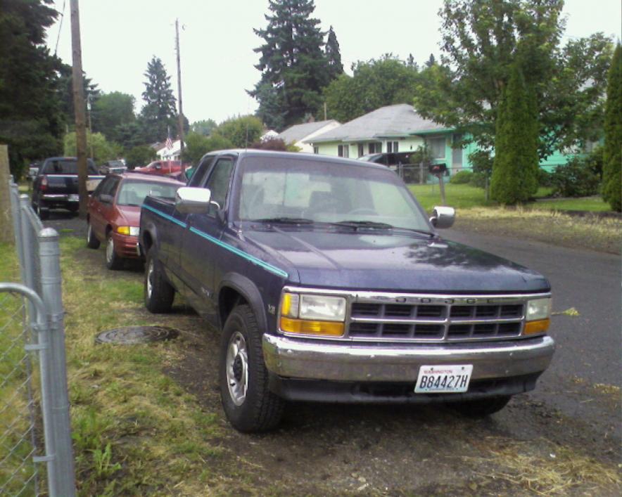

thats a steal for 850 i payed 3000 for my 92 318 but i love every second of it

Thanks, here's a couple pictures of it, sorry the quality isn't great they came from my phone. Also thanks for all the advice so far, I should have it narrowed down by the end of the day!
