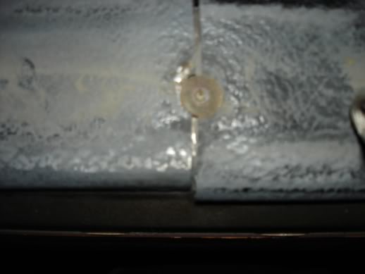

**Also on the subject of holes, I have to remove my busted up plastic bedliner aswell before I paint the truck. sadly it is RIVETED in. Many More holes that would need filling. Any suggestions?
As a side note I'm planning on using rustoleum bedliner but it's not really supposed to go on that area (top) of the bed like a plastic bedliner does. But If I absoutely had to do it I gues go over that top portion with the bed liner.
