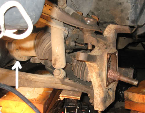

This is the flange that I am guessing I have to take off to get the axle out? If that is the one I am supposed to take off then there is no fluid to come out?

nope, no fluid,
the fluid is on the other side of that flange, it unbolts to another flang, which is your inner axle, that axle seals the fluid.

No there is no fluid. The plate that the cv axle bolts to (the flange as you called it) is sealed from the axle houing.

So I do take the flange off to get it out? (not remove the boot to remove the axle) Im new to all this front end steering and axle stuff as Im sure you guys can tell.

and one more thing, how do I get those bolts out and stop that flange/axle from spinning?

If you remove those 6 bolts, the cv axle will come free.
