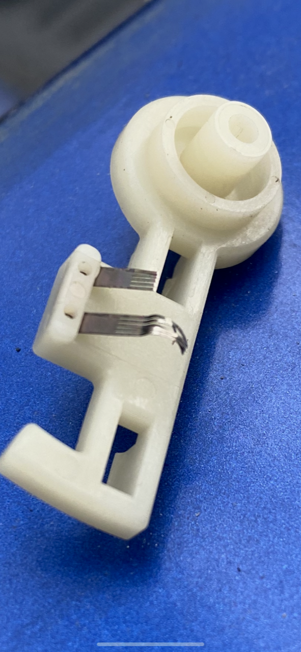

This was the problem with my 93 Dakota, sending unit float arm bracket. One of the metal pieces was broken off. No Connect, no send signal to fuel gauge.

Check under that float arm bracket. I replaced this little fella and I now have fuel gauge working properly.
