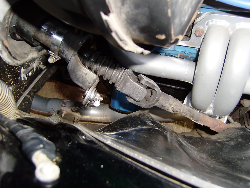

Before you go tearing apart the steering column, have you checked the linkages under the truck to make sure the swivel lock bolt is still tight?

Thanks for the tip but that parts all fine ive upgraded it to cable.
There is some kind of slip in the column islef the shift arm stays still but the gear lever in the cab goes up and down!!!

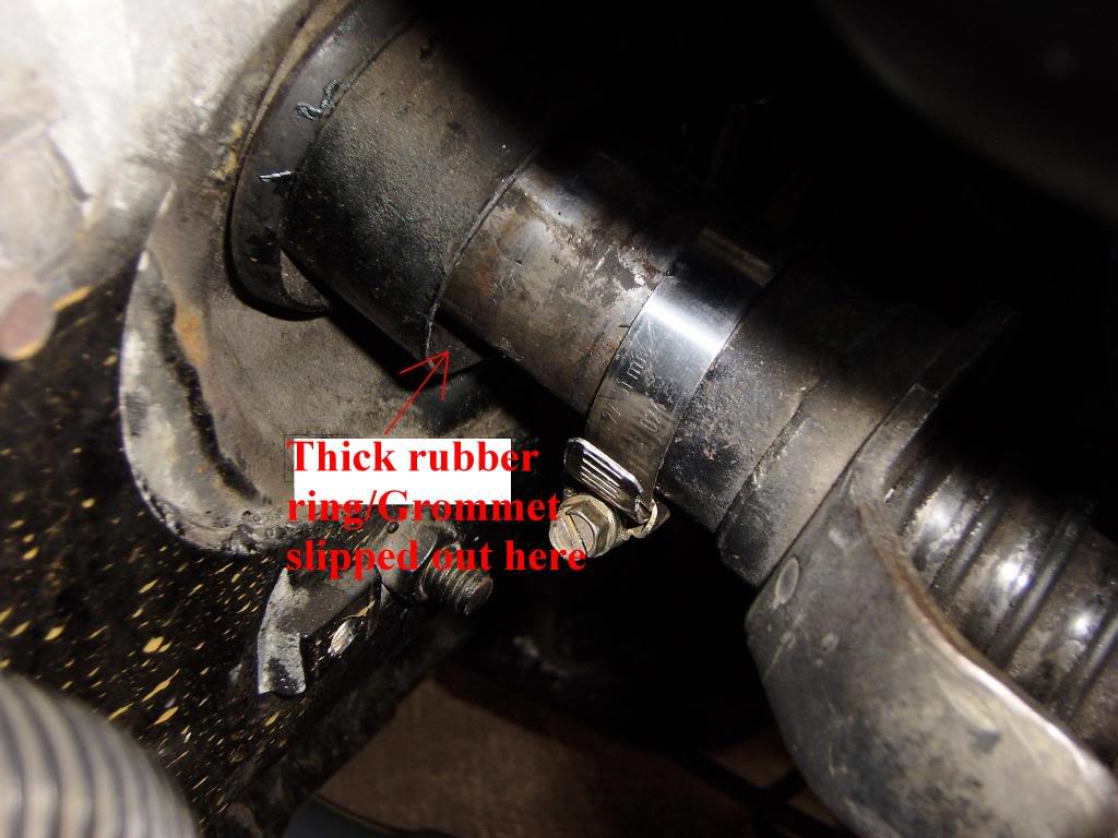

I have diagnosed that the problem is on the column not the cable
A thick black grommet/ring slipped out i have added a pic to show your guys
I pushed it up and it fixed the problem before slipping out again.
I pushed it up with a thick wire and put a hose clamp to prevent it falling out again.
I must have pushed it too far as now i can not feel it and the shifting problem is bad
The gear selector moves up and down in the cab but not in the engine bay.
If i undo the plug from the gearbox than it moves fine.
ANOTHER MAIN PROBLEM I HAVE is i am located in Sydney Australia and this is the only 87 Dakota i know off here in the country so i cant just go down the road and pick up a column.
Any help will be most appreciated
