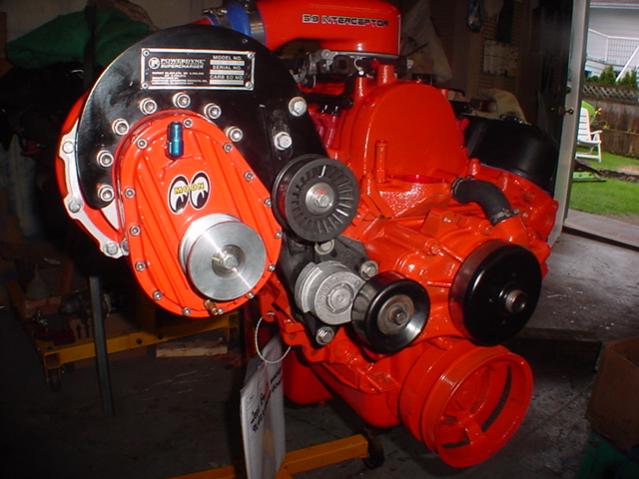

I recentaly pulled the stock 5.9 (gas) and 46RE out of my 1500 and replaced it with a 408 stroker & 518 TCI transmission. I want to put the 5.9 & 46RE in my 69 Valiant project. How can I get the 46RE to work properly without the computer? (obdii). Thanks all

That would be a sweet project. The 46re is electronic and controlled by computer. For that specific transmission you have 2 choices. The stock style computer that works the engine as well and transmission control. The next option is a aftermarket stand alone transmission control computer. Just go to google spend some time searching.
