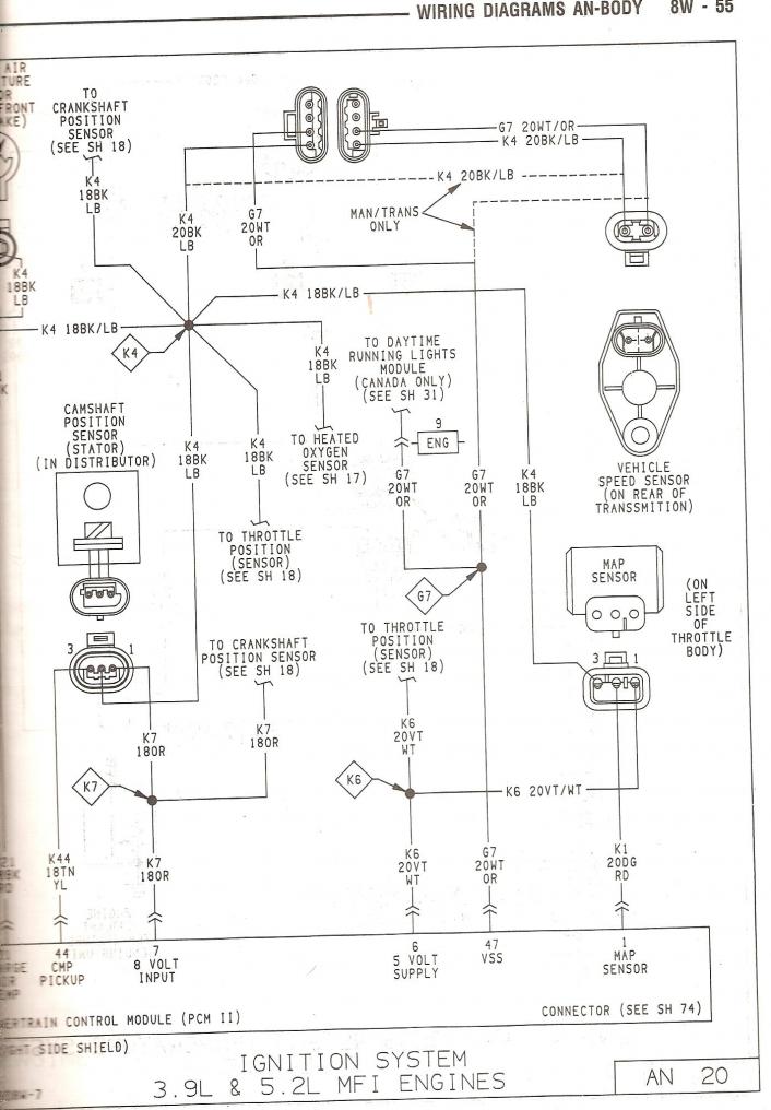

Cool! I'm glad you got it. I scanned this wiring of the 93 speed sensor earlier, but didn't get to post it up. I will post it incase it will help someone else down the line.
By the way post up pics and videos of your swap.
