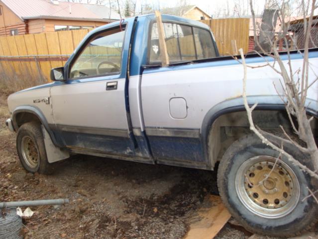

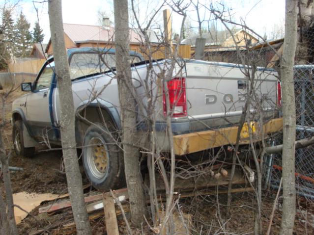

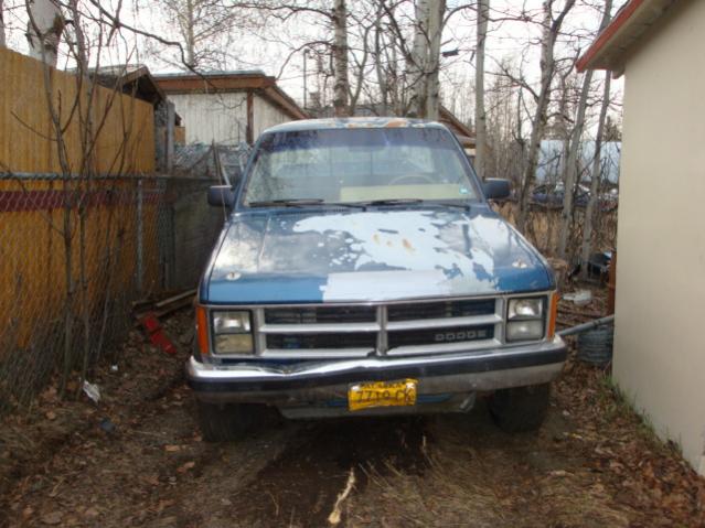

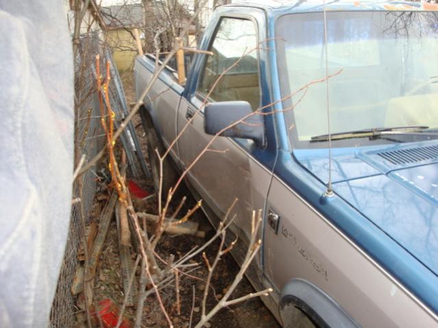

SO it is an 89 dakota 4x4. was a v6 engines out already. easy swap. but with my truck being an automatic and this one the manual, what flywheel and clutch would i need to get. and maybe what could i do to temperarily beef up the transmission for security lol. its hard not to get in the throttle lol.
