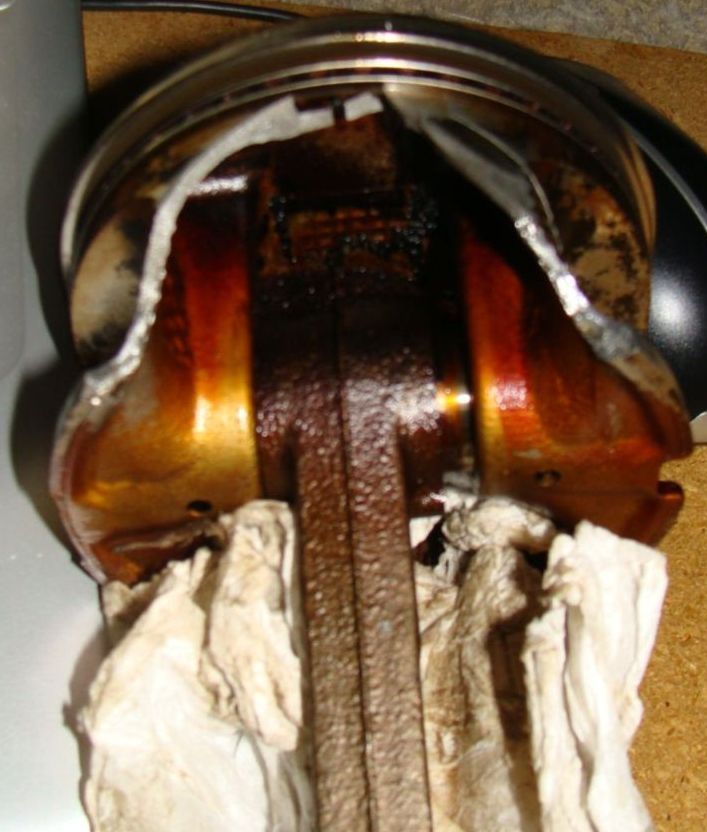

Well it's time for a rebuild, found the parts I need cheap by calling around. One of the parts I need isn't cheaper then the rest but hey I'm paying for quality. Well I took off the oil pan and what did I find anything good perhaps NOPE! I started out by filtering the oil before I took off the oil pan (looking for metal fragments) didn't find anything. Well I took off the oil pan and what did my eyes find? My big eyes, found metal chunks. Well during inspection of it, I found that the number 3 piston was shattering with every stroke. The crank is find and so is the cam and so is the cylinder walls no scaring what so ever (god I'm lucky). Well the correct way to do it is to replace all 4 pistons, bearings and rings, now the question is what am I going to do, replace one or all 4. Well I'm going to replace all 4, found the pistons, main bearings and rings for the low low price of $240. Now on Thursday, I'm gonna be putting it back together with the new parts lol. Hopefully I'll be lucky and I wont have to do anymore work to it for a while. But I'll still be on here answering questions or posting them as well.

Tomorrow I have to go down to the shop and remove the arms and pins out of the pistons but I took a picture of the one bad one to show you the damage of the piston and how much of a chunk that was came off.

That looks like a fresh break. My question is, what did it hit?

It didn't hit anything that's the thing. One of the master techs I know, looked at it and said it is a common issue with my motor after it hits 100k+ he said the people who made the pistons didn't think the motors would run for as long as they did. Nothing I did caused it, it just happens
