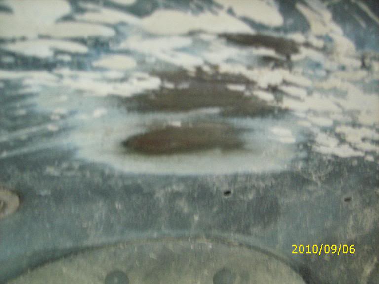

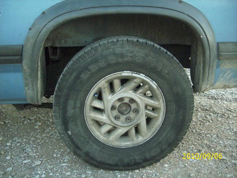

now the only thing about the front tires is that before I replaced my shocks (had no shocks) , I had 225's up in front with no rubbing. I put my 225's from the back up front after shock change and they rub the top of the fender. This confuses me, only thing I can think of is their tread is about a 1/2 inch taller. After I replaced the shocks and before I swapped tires, there was no rubbing. How would I fix this? BFH "nicely" to the fender in the spot its rubbing?

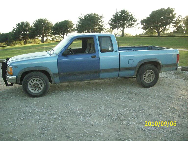

well, finally got out with the camera.
1st picture is my rubbing

it looks like your brush guard isn't attached to your truck.
i had those same tires on my truckas what you have on the front. i slide into a curb and on blew out and the place i bought them from wouldn't honor the waranty.
and 225's shouldn't rub. i have them on my truck and they don't rub at all, even at full wheel turn.
your first pic looks like you hit a bump at 40mph. the inside of my left fender looks just like it from hitting the same bump at 40.lol

it usually only feels like its rubbing when I drop down a curb or a hard bump in the road. The first thing i did was go over a speed bump at a little over normal speed lol. truck hasnt seen shocks in 3 years, had to give it the feeling. All I know is these trucks have very heavy front ends lol.
