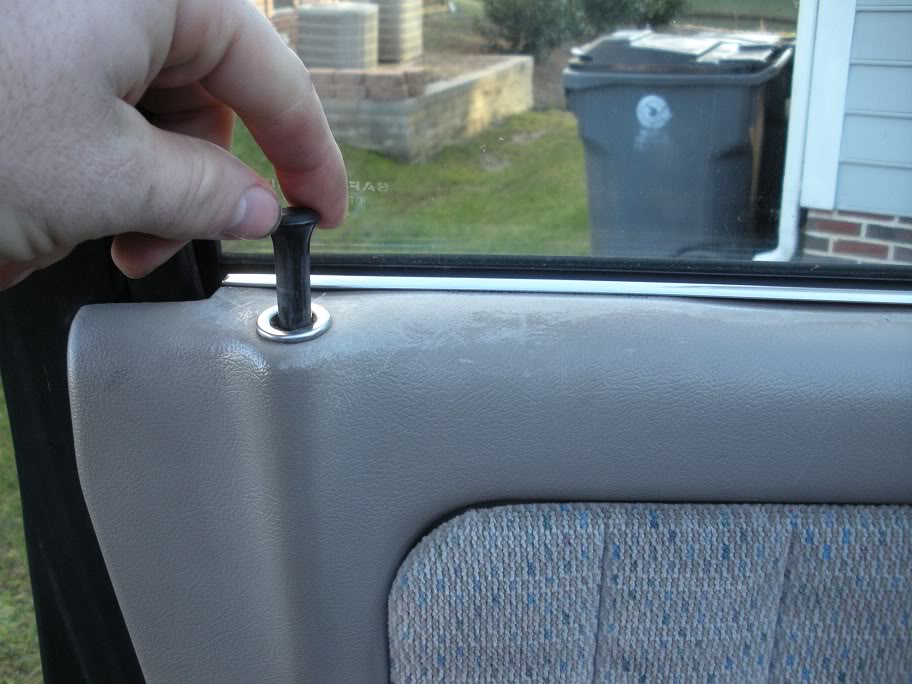

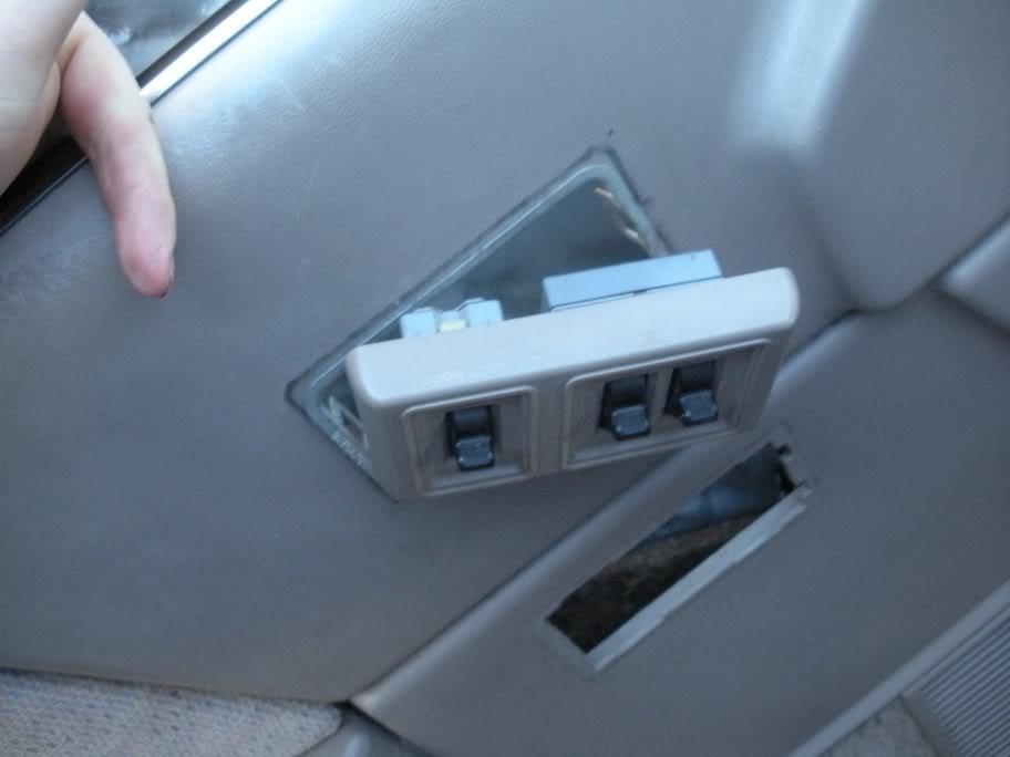

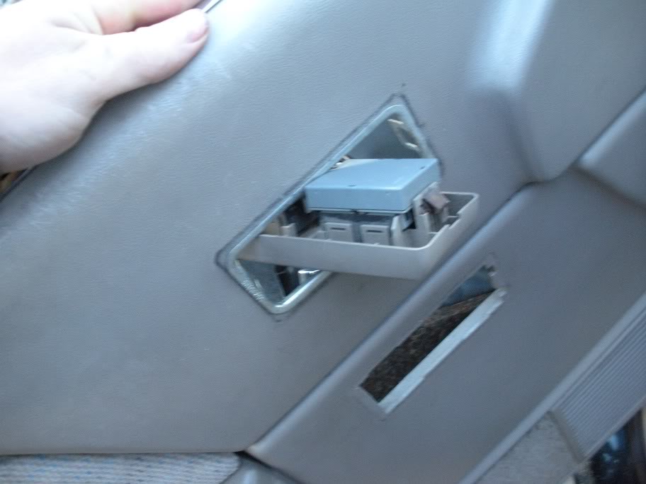

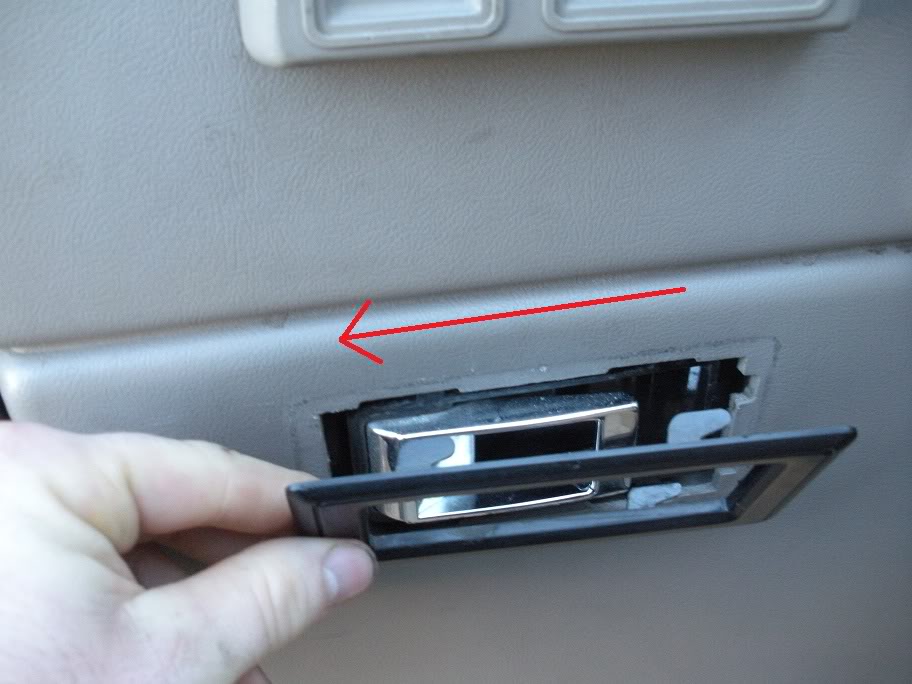

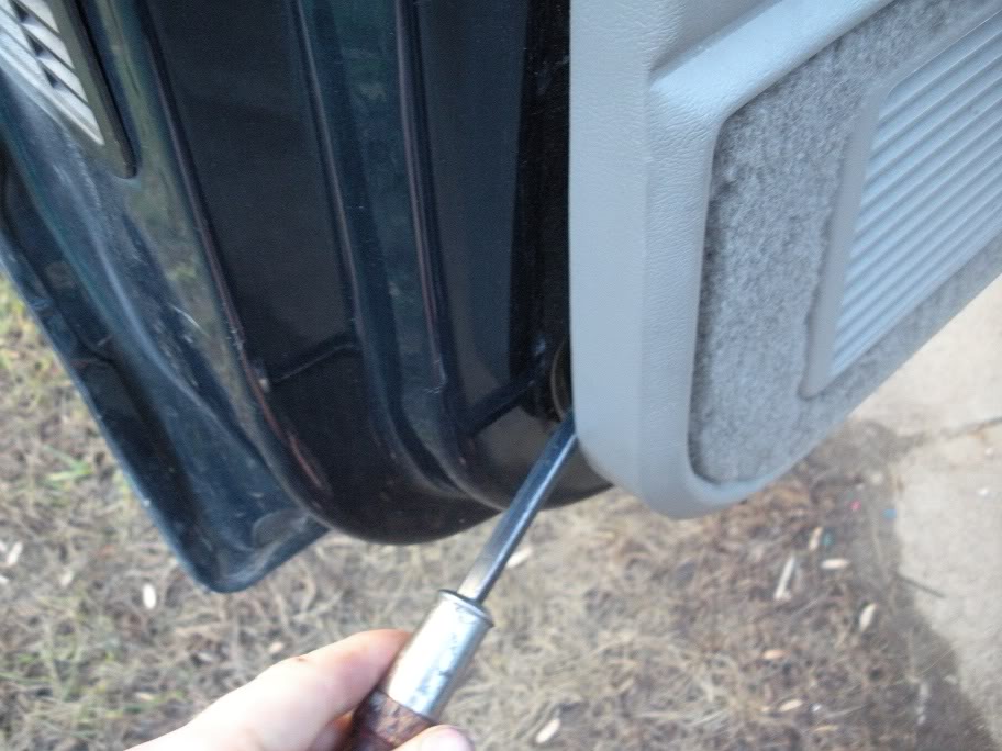

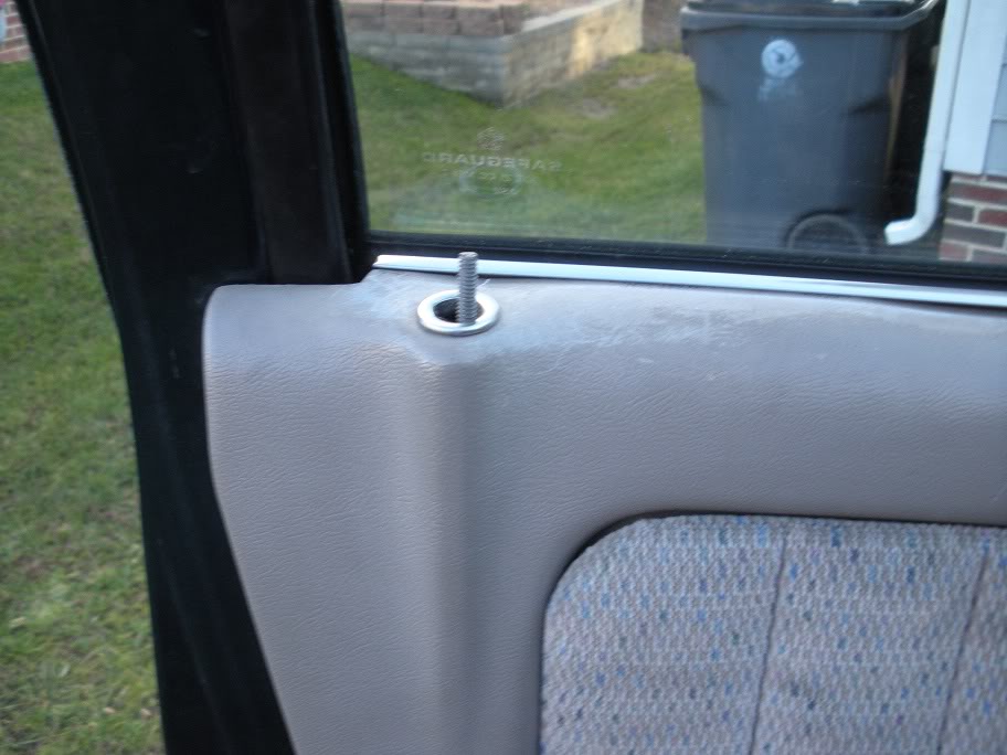

You don't need to disconnect the PW/PL switches! Just push the whole switch panel through the hole in the door panel once you pop the door panel loose. I've never unhooked those connectors.
