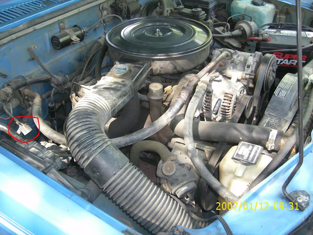

  • Checked all plugs, etc (found one unplugged but not sure if it was before ill put pic up of it at end of this)

That one wire was unplugged before

That is the diagnostic connector. You hook up a code reader or scanner to it. It is normal for it to just be hanging there. It is not the source for your problem.
Since you messed with the distributor it sounds like you messed up some wires or the spark plug wires. Maybe hooked up the coil wire to one of the plugs instead of the center of the cap. Check your plug wire locations.
