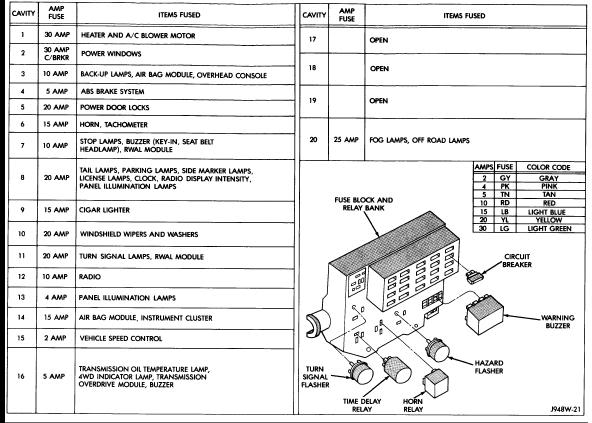

My brake lights are not working!! Do not have owners manual so I have no clue if there is a fuse that might have blown and I will not go ONE BY ONE!! They light up with the headlights and turn signals work. Is it a fuse or a relay if anybody can give me a link to the fuse box layout or can just tell me the fuse or realy #, or if the problem is even a fuse thanks...

I suspect brake light switch on pedal is the culprit, if the fuses are good...

I too, would suspect the brake pedal switch after checking fuses.
Hope this helps!!!
