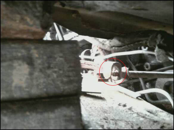

Got the steering column fixed, now my other issues. The RPM gauge is sitting at about 1400 and doesn't move, the speedometer might not move either, I'm not sure because it's running really rough and I haven't driven it. The gear selector indicator also doesn't move, is there a way to get that back connected?
Also, am I missing a clip in my picture? It's a picture of the rod that comes out of the transmission and the bracket it sits in on the other end. The problem is that every few times I move the shifter up and down the bar pops out of the bracket and I can't shift anymore. Is there supposed to be something there holding it in place?
