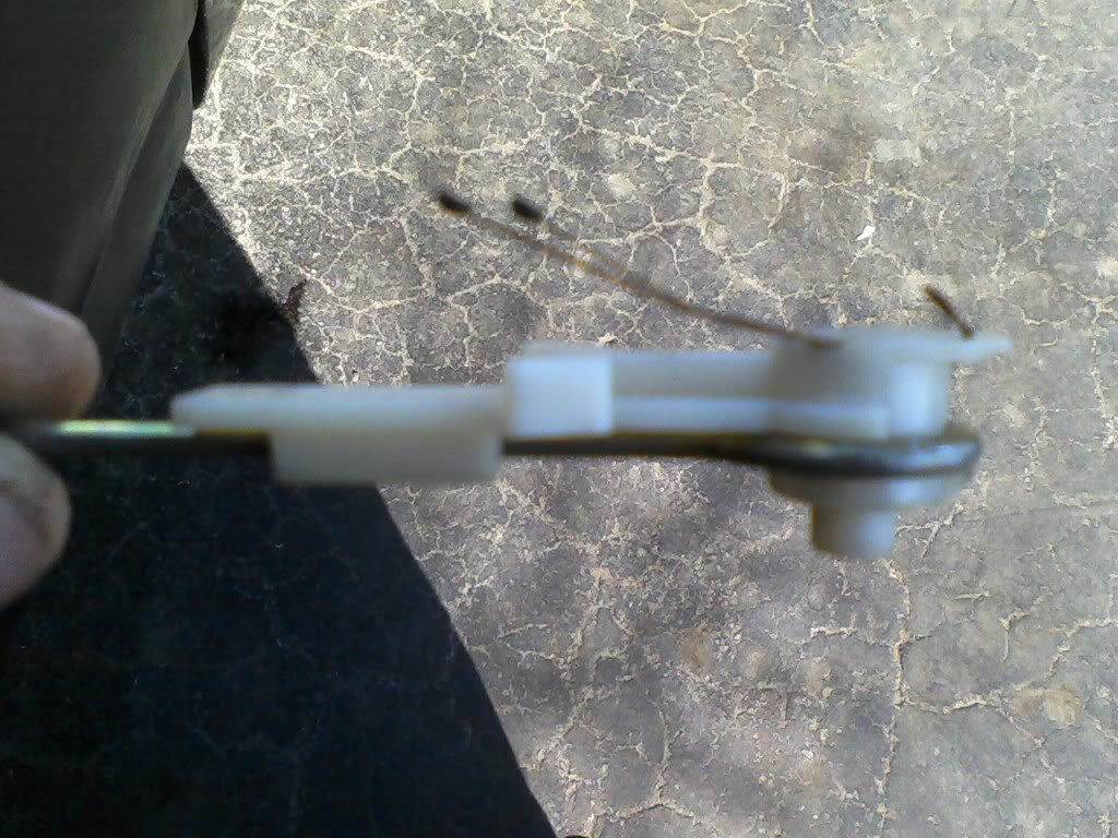

thanks. here's the pics. I apologize for the huge photos and some of the blurry ones.
notice the gap.

now the lack of gap.

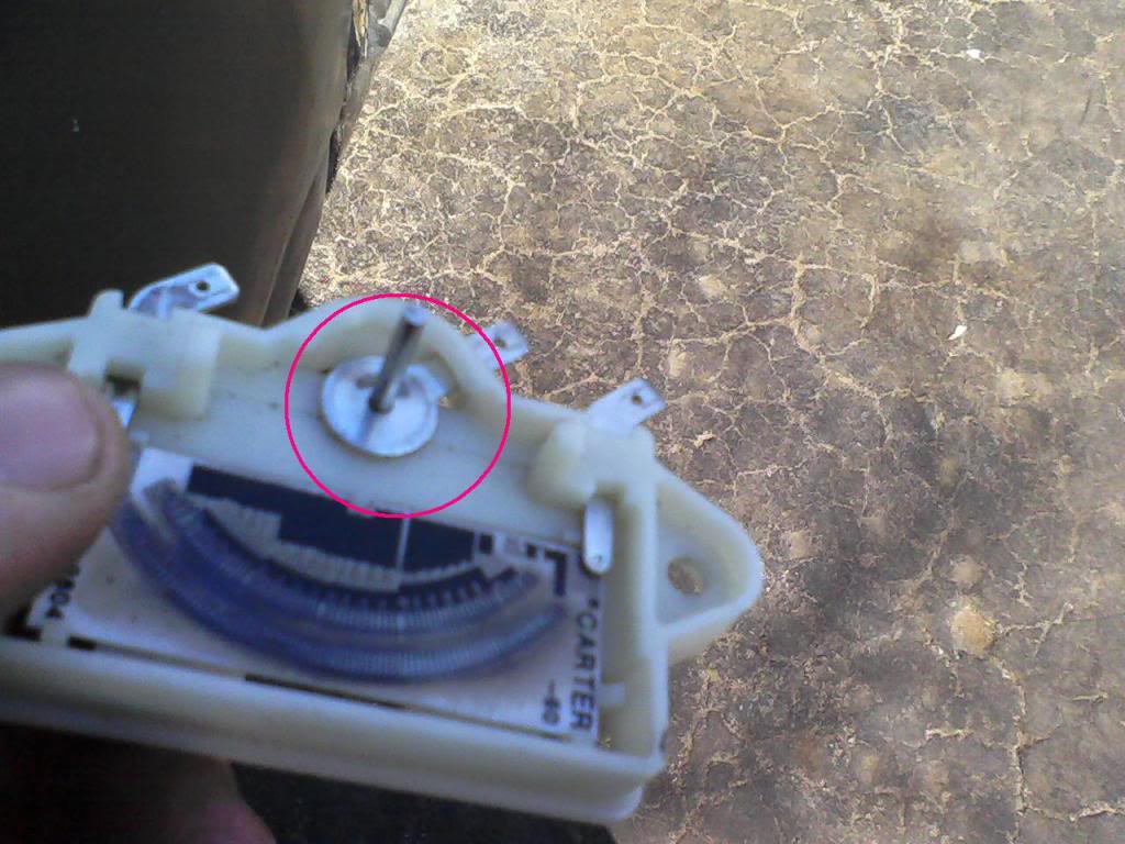

it was pivoting on this rod.

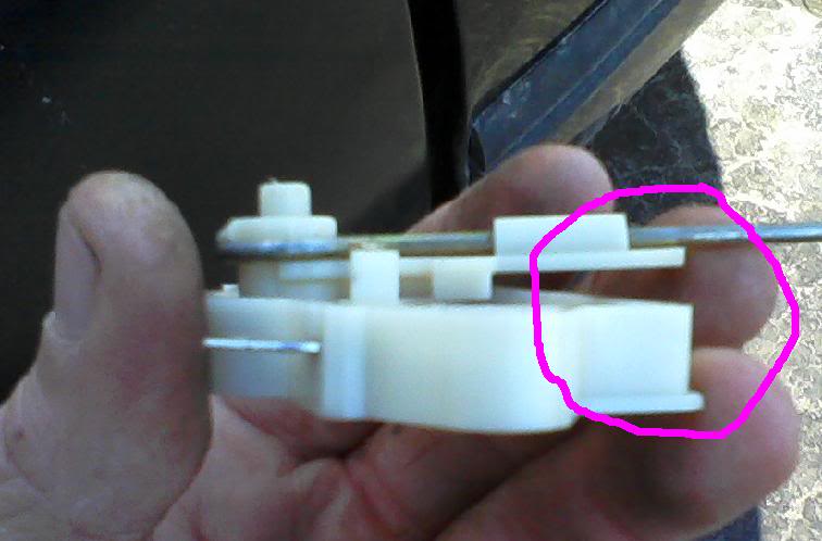

causing this tab to lose contact.

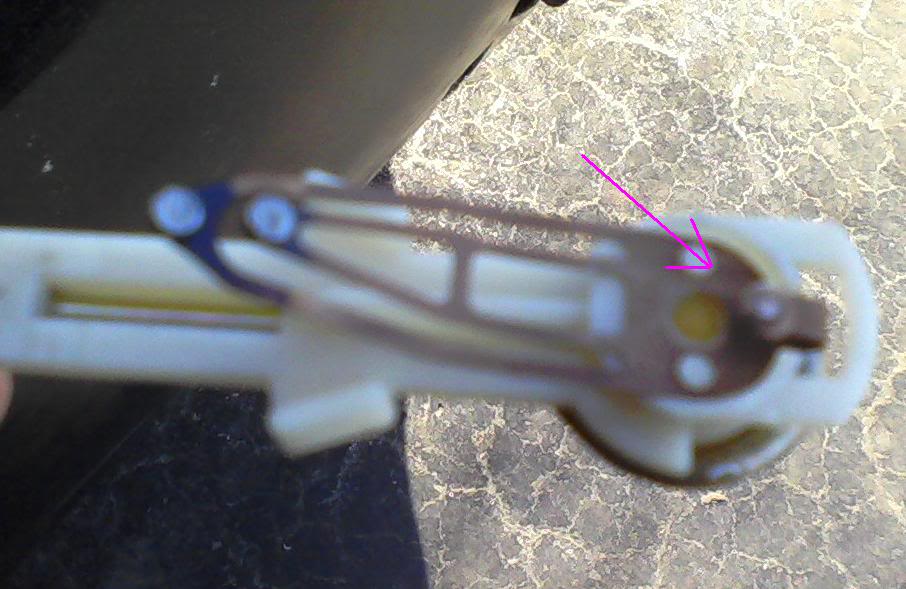

so i bent the tabs(all 3 of them) outward to fill in the slop from the wobbling float.
