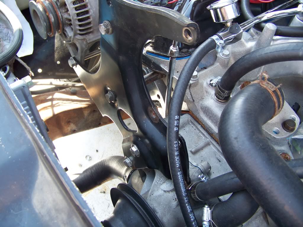

Here is the bracket as it exists. The rear bottom of the alternator is what I am curious about.

I see you have it installed. What is the question/problem with it? I see you need a spacer in between the bracket on the lower bolt. And the top mount needs to go somewhere, but it looks okay from here that is.

That is what I am confirming. What does the "spacer" look like? As far as the top, are you referencing a support to the manifold?

The lower mount for the alternator usually will have a hollow tube/bushing/spacer (Green Arrow). A sleeve that goes in between the tabs of the alternator. So when you tighten it up everything will be tight against a solid object. Without it the alternator inner tabs are loose.
The Blue arrow is pointing to one that looks like it might be a similar object.
The Red Arrow is the top mount hole that looks way to tall for the intake. Where does that go?

The red arrow is the top bolt for the a/c delete pulley. There are two more at the base for triangulation. So the "green arrow" bolt only has a bushing for the alternator?
Yes. You can just get a small tube and cut it to size.

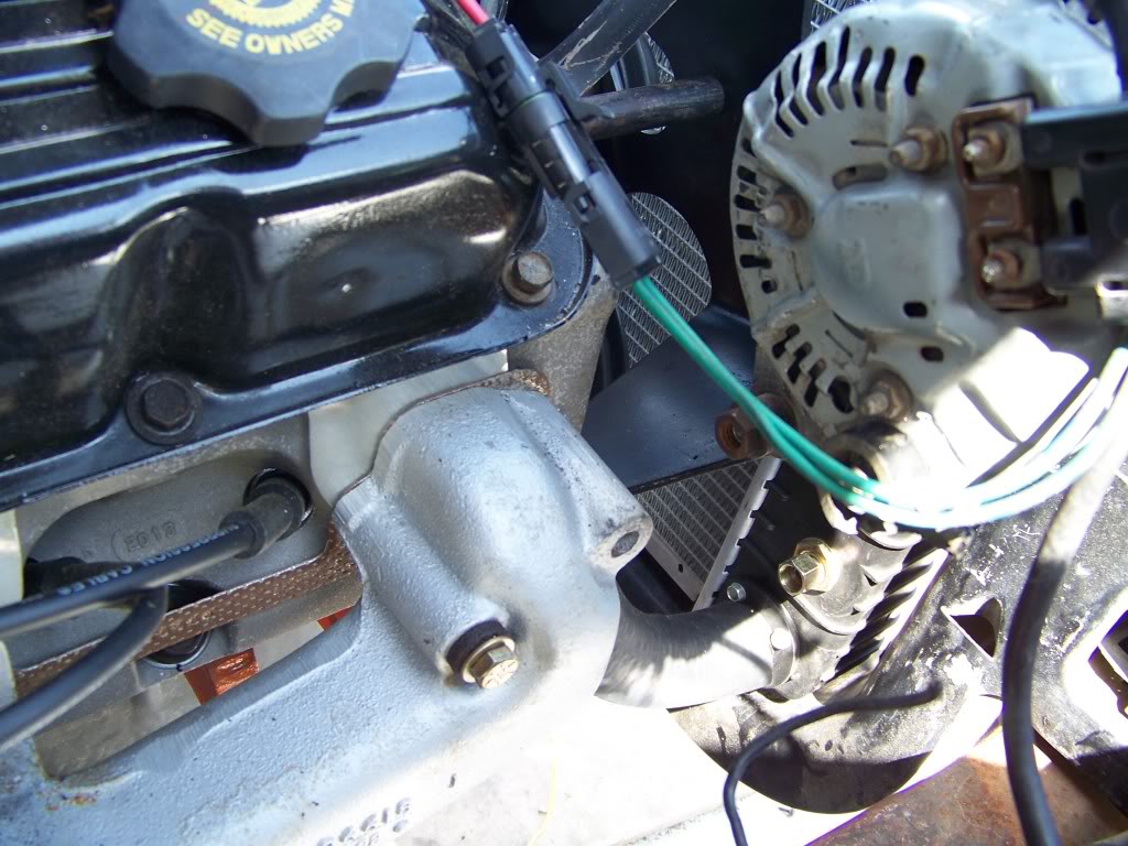

I found the only non a/c dakota in Florida and borrowed a few parts. As you can see in the pic the is indeed a rear bracket for the alternator. I took the loom as well, because I liked it more than mine.
