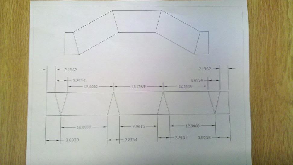

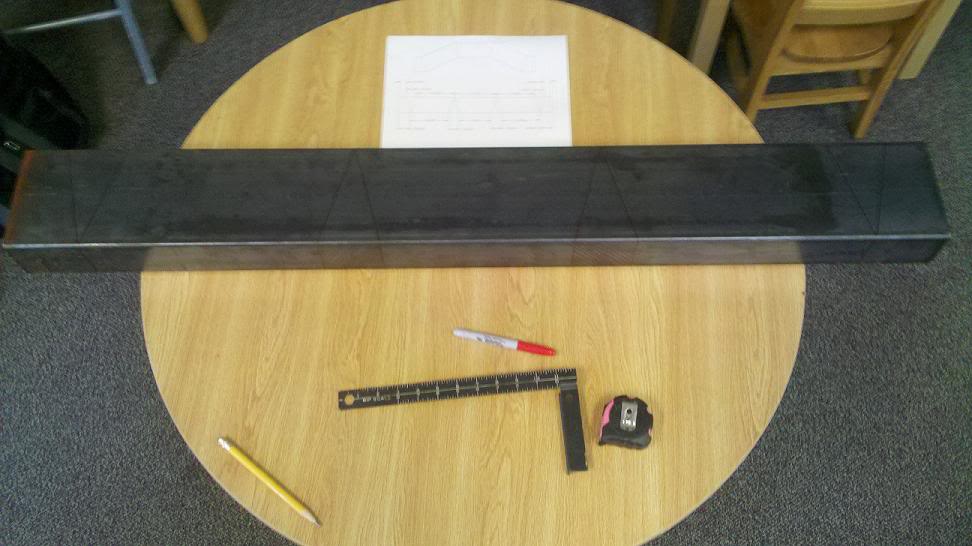

Well most of my parts got delivered today for the rear 3 link. Here is a picture of the crossmember...

And I drew this up in AutoCAD how it will be cut/bent/welded into the crossmember I need...
