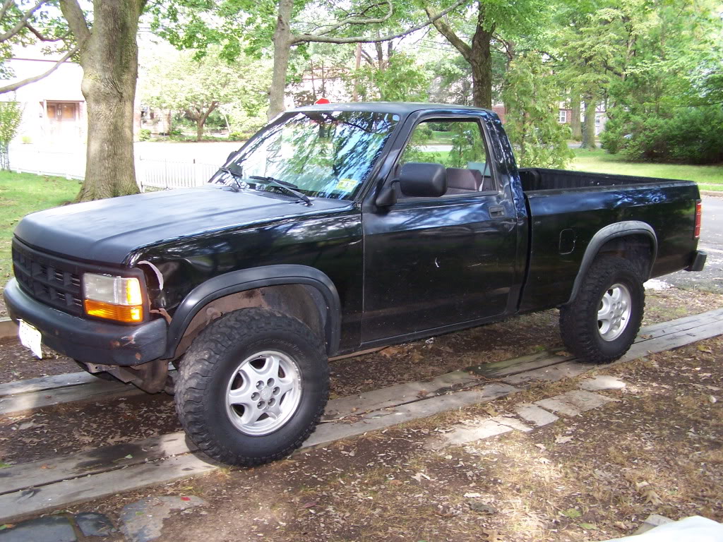

I have 31/10.5/15's on mine with just a T-bar lift....

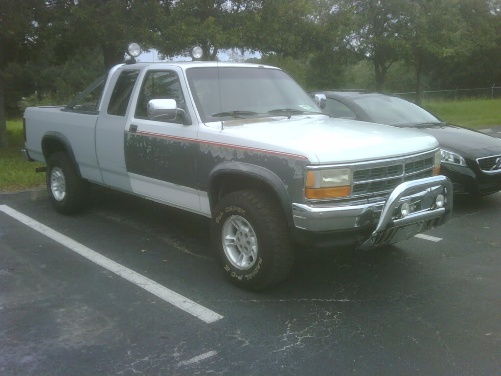

^Those are 15" wheels? What're they from? They look like the later dakota 16's.
Mine has 31x10.5R15's, stock height.

yeah there 15's from an 01 Dak sport
